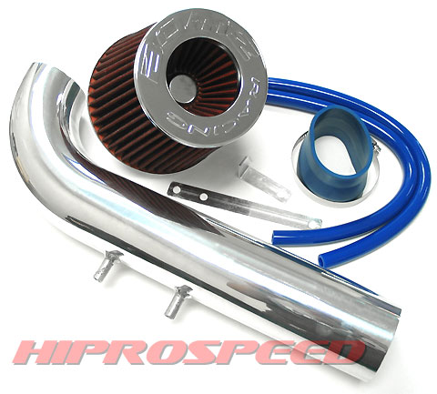

hey guys,
I just got back in town and I finally had a chance to install the new intake. I must say I am VERY impressed. The car SOUNDS like a V8. Before i just attached a filter to the stock airbox but the stock airbox is highly inefficient, so a new intake had to be engineered.
First, i removed stock airbox and and the temp sensor. in stock position on the 6cyl's the HFM is verticle instead of horizontal like on most cars, that means the air was bent before the HFM so readings would be inaccurated. I relocated HFM to horizontal positing and in doing so the readings will be more accurate and etc. So i used a custom 90 degree curve Sanded down the edges and everything and then used the rubber couplings to attached it to the HFM (Throttle body has its own special couplings so i just reused that). next i put the filter onto the HFM (I may eventually add alittle aluminum pipe for more air stability). for now I have the open air filter b/c the CF one didn't come in the mail yet.
Noise: WOW, even compared to the air filter on the airbox, its alot more aggresive sounding, when you open up the throttle you really hear the engine roar, at part throttle and cruising its barely noticable compared to before. Stock the car was completely silent but now you can hear the throttle body in action and you can hear engine really grunt.
Fit and finish: I painted the aluminum pipe black to give it a much more OEM look. i still need to find a black coupling b/c the blue one is kinda ricy. It fits perfectly into place and when i get the CF headshielded filter it will be perfect for ram air openining in the grill.
Performance: The ECU takes a while to adapt usually but even so initially the results are awesome. I can already feel the extra torque on the bottom end and off the launch i am having trouble getting traction on 265/35/18's out back !! i can definately feel that extra torque. once the ECU adapts it'll be even better. I will take pics once its completely done (digi-cam is at home right now).
rating: 9/10
Future Modifications: Performance ECU upgrade, Custom Exhaust system with high flow resonators and high flow exhaust and dual chrome high quality tips. Can't wait to redyno after everything
P.s. If anyone is interested in me producing a kit for you guys lemme know.

LAST UPDATE:
hey guys, well the new air filter finally came in the mail today and I couldn't wait to install it. after getting it i was releived to find out the overall diameter was almost same as the filter before so fitment under the hood was no problem. the CF-look heat sheild looks much better than an open air filter and above all else its position is perfect.
Install took two min, take old one off, slap new one on...
Results: Well first off the idle was much smoother and revs seemed to rev more freely. There is a difference in sound, its actually quieter than the open air filter because the heat sheild restricts the sound to only coming out of the front of the filter instead of echoeing inside the engine bay. However, it actually sounds better and much more refined and mercedes like than open air filter b/c it reduces that loud low end grunting sound that wasn't very refined. The position of the filter is perfect, the front opening of the heat sheild points DIRECTLY to the ram air inlet in the front grill so the air is literally rammed directly into the filter. at lower speeds you can't tell a difference but on the high way passing and lane changes and etc are much smoother and it really pulls alot more on the top end. For daily driving its also better. for some reason the car shifts alittle smoother now. Also the engine responce is better because the Conical shape of the air fliter ( V vs. W shape) allows for much smoother air flow and it smoothens the air out alot more befor the HFM sensor for more accurate readings so the A/F ratio is much better than with open air filter. Also not to mention theres not nearly as much heat being sucked it so its much more of a cold air intake than before. Under hard acceleration the intake sounds much more refined and mercedes like, slightly quieter but a much higher quality sound and you can really hear that mercedes scream up top. Overall i'm very happy and give it about a 9.5 out of 10.
Overall intake price = $48
Estimated gains = about 5-8HP
I will have pics as soon as i can possibly get my hands on a Digi Cam.
P.S. look for my future mods to come, Custom Exhaust and chip software.
Old Dec 31, 2004 | 04:47 AM
Bernanke's Avatar
Joined: Jun 2003
Posts: 1,179
Generic picture of the intake i used (That was the first air filter i used and i only used the 90 degree curve, the rest was left over, I spraypainted it black to look OEM, intake is 3" diameter tubing)
Picture of CF-look Air filter + heatsheild
well guys, hope that give you a basic idea of the parts i used. as you can see you can make something high quality out of basic parts, its very simple you just gotta think about it a bit and design a good intake. this design is only for the 6cyl cars but you can definately apply same techniques to V8 and V12. Hope this helps yall think up some cool ideas. ttyl
