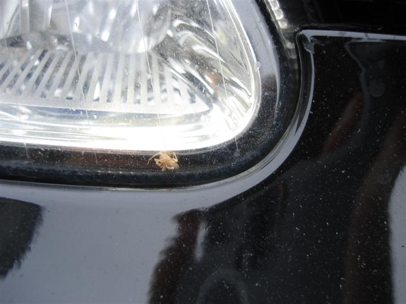

One of my headlights is just a TINY bit cloudy than the other one... only I can notice it.
I don't know how airtight it is, but in one of the corners of that cloudy headlight, I have a dead spider...
Pictures to follow tonight...

The Spider. He rides with me EVERYDAY.
