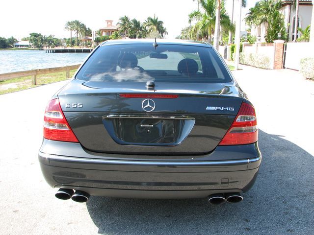

I would suggest you make sure you understand how they install the antenna for your sat radio. If I remember correct, a few people didn't know how it was done and where upset when they found out that they drill a hole in the top of the trunk.
