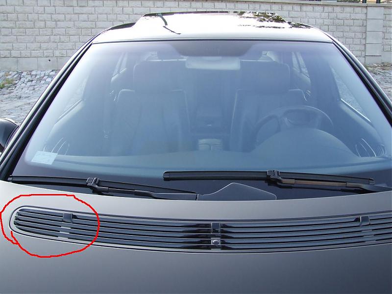

This problem is caused by the drainage plug on the pic getting clogged. Leaves and dirt gets in that AC suction vent area and clogs the drain plug and once the water tops out, it has nowhere else to go but inside the car following the AC duct system. I experienced this on my 2000 S500 and that was a very painful experience. Open the hood, gently pull that plastic covering, stick your finger through there and feel for the plug at the bottom. Once you locate the plug, unclog it and push it all the way down to relieve the water. Now for the damage. Once water gets in the system, it corrodes the electric system. You will need to remove your rear seat and expose the rear SAM that has all the fuses and check for corrotion. It may or may not be visible by just looking. It has probably corroded and makes your rear lights stay on. Your defrost will probably not be working either, your soft doors not working and everything else controlled from that SAM. My suggestion is unplug the battery to avoid further corrosion of the electric system. Your Rear SAM may need to be replaced once it has corroded. The more you drive or try to, the more damage you cause. If you can't do any of these, then take the car in for repair. It sucks but it happens.
