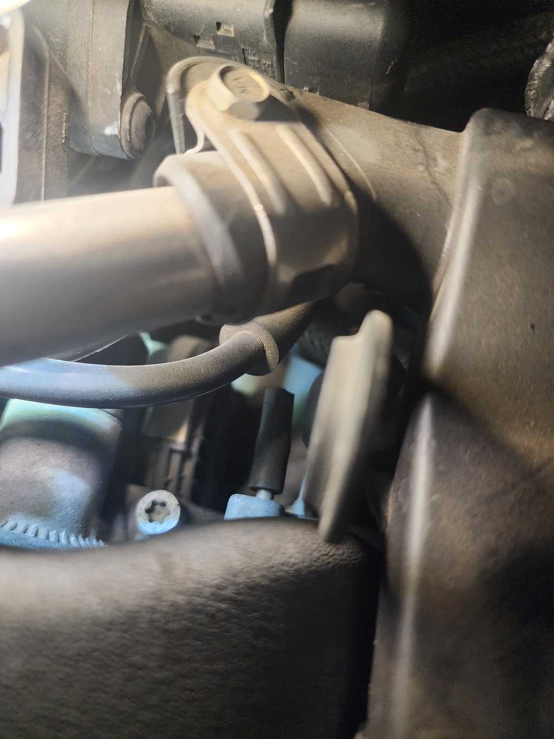

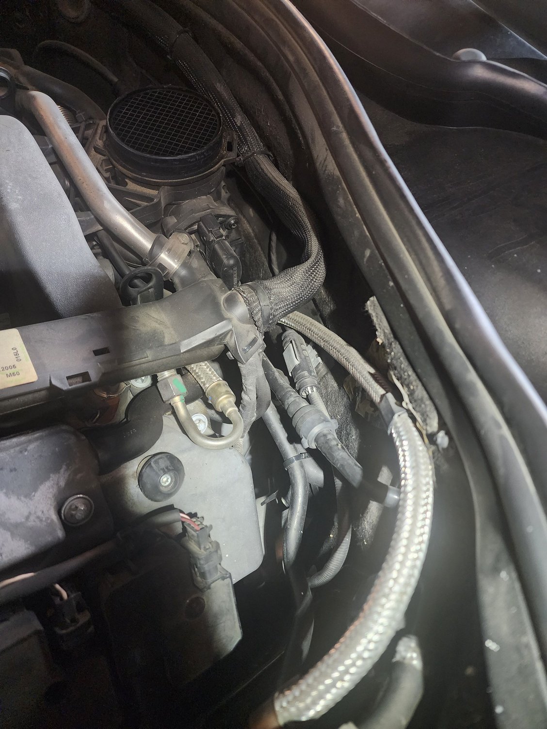

Old Dec 22, 2024 | 11:45 PM
  #56
SuperSL's Avatar
Joined: Sep 2022
Posts: 33
Range Rover, R129
Found the plug. IDK how you guys are unplugging that tiny connector with that metal plate in the way. Does it have a retaining clip on the underside as well? Either way my hand is too big and doesn't fit so I'm going to leave it as is. This was a preventative thing, I'm going to leave well enough alone for now.
Thanks guys.
