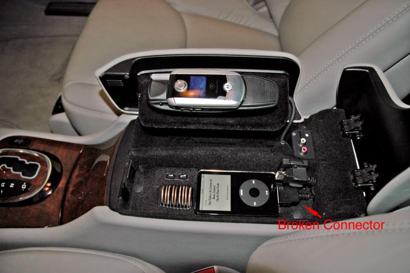

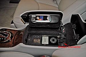

Ok, your S600 uses a MOST fiber optics bus. The units that are most likely installed are the Dension Gateway 500, a mObridge unit, or a Cartronics unit. There are others, but these will be most common. The Gateway 500 does not force you to give up your CDC; it simply replaces it on the bus, but it can be switched back in.
The mObridge and CarTronics units require giving up the CDC.
Below there is a photo of the Gateway 500 installation in my S500; click it to enlarge. Yours can be entirely different, because the installer (me, in my case) determines where to locate various inputs. But in particular, look for the module with the red & white RCA jacks. If you have that (and it may be in the glove compartment or elsewhere), that's where you could connect your Zune. And, if you have it, you can download the operating instructions from the Dension website - http://www.dension.com/index.php?pageID=170 - the Mercedes COMAND quick start guide and the Gateway User Guide are the ones you would want.
Disregard the annotation in red in the photo. The broken connector was fixed long ago.
In addition, on the same unit with the RCA jacks, there is a switch. It would be currently in the Gateway 500 position. If you place it in the opposite position, shut down the car, wait about 1 minute, and restart, you will have the CDC back; the iPod adapter will be switched out of the fiber optic loop (bus).
If you don't have that box with the switch and the RCA jacks, you likely have one of the other units.
The Gateway 500 will give you song title and artist on the COMAND screen (it only gives track number on the instrument cluster display); lets you sort by playlist, artist, or album on COMAND, and of particular interest to you, it (as well as the other two brands) provides fiber optic input to your audio system from the main connector instead of the earphone jack - resulting in much better audio quality. Unfortunately, your Zune would be limited to audio output through its earphone jack.
And as mentioned before - any of the units addressed here provide iPod control via the steering wheel or the COMAND buttons. That control is not possible for something connected to the RCA jacks.
