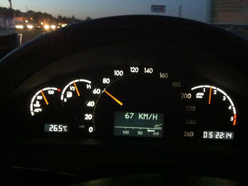

Hi all! I have spent many months reading this forum and most of the information I hayado in this forum, I have been very helpful.
I am writing to to pose a problem with the system Distronic my S400 CDI 2000.
After reading all about it Distronic in this forum and a lot of pages, I have not found the problem.
In the center screen of my instrument panel, the error "Distronic go to the shop." I removed the connectors on the radar, I've cleaned and I have not managed to make the system work. I have reviewed Distronic system fuses and all are in perfect condition. I removed the battery and have done a full reset of the car, following the instructions found in this forum, and the resulting fuel the same "Distronic go to the workshop"
I work in a lab as a technician in electronics, I have no fear has disassemble and check the module or Distronic radar, but I would like to help me start with this work.
I have read that you can align and reset the radar, but not if I can do with the cable diagnostics that will be on my office on Tuesday (Carsoft 7.4) Do not know how to find out if the problem comes from the module or the radar.
If someone could help me with this issue would be very grateful.
Excuse my English, I'm using google translator to write in this forum.
Old Jun 13, 2012 | 05:32 PM
el_satri's Avatar
Joined: Jun 2012
S 400 CDI
well, as already repaired the Distronic module. failure in the power input module, replaced broken components and everything works fine. thank you all a greeting anyway.

El Satri - could you please give more detail on your repair?
Where is the module you repaired, how did you troubleshoot? What did you have to replace?

I would also be interested in how you fixed the problem.

Main control module located under passenger foot rest area. My module was fried and had to be replaced and coded via SDS. Fixed my problem.
