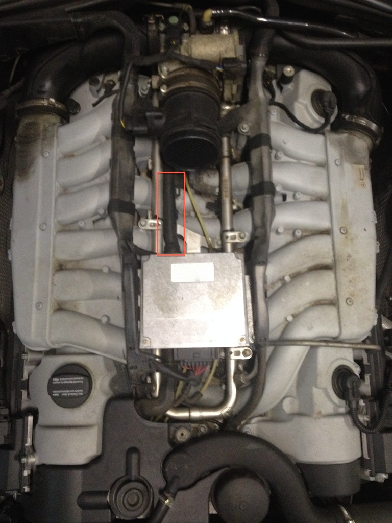

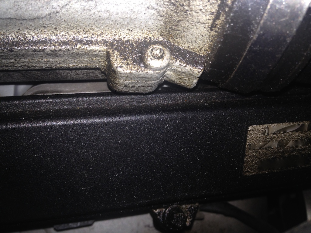

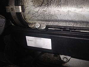

Hi - I've decided to save some money and change the Left Coil Bank as well as all the spark plugs myself. I've watched a few videos on the coil pack and feel pretty comfortable with that. The question I have is around the spark plugs. I have ordered the Bosch 9652 (Iridium Fine Wire) as replacements. Do I need to use dielectric grease? How tight do I fasten them? Anything else I should look out for? Also, does anyone have any videos or photos documenting this procedure?
I have removed the Air Filter and there seems to be oil stains underneath them. Is this something I should be concerned with? Also, it looks like there is a fuel line running over the Left Coil Bank. Assuming I can unscrew it just above the coil and remove the hose?
Here are close ups of the driver and passenger side heads and coil packs. The drivers side has a ton of oil on it. Assuming this is a bad gasket?
Thanks.

Oil in Intake
Why do you want to change the coil pack and Plugs?
The oil may well be a disfunctioning crankcase ventilation system, that results in oil flooding the intake manifold.
on the front cover of the right cylinder bank is a black rubber hose that then runs along the right fuel rail to the aft throttle body.
This hose must be soft and squeezable; if it is hard the PCV system is blocked and has overheated.
There is a MB Star Bulletin P-B-01.20/13 that explains.

The CEL came on, so i took it to be diagnosed. I was told the left coil bank need to be replaced as well as the spark plugs. But it look like that just might be a result of the clogged PCV?
Is this the hose you are referring to? If so, it's as hard as a rock.
I am very new to all of this so I appreciate the help and patience.
