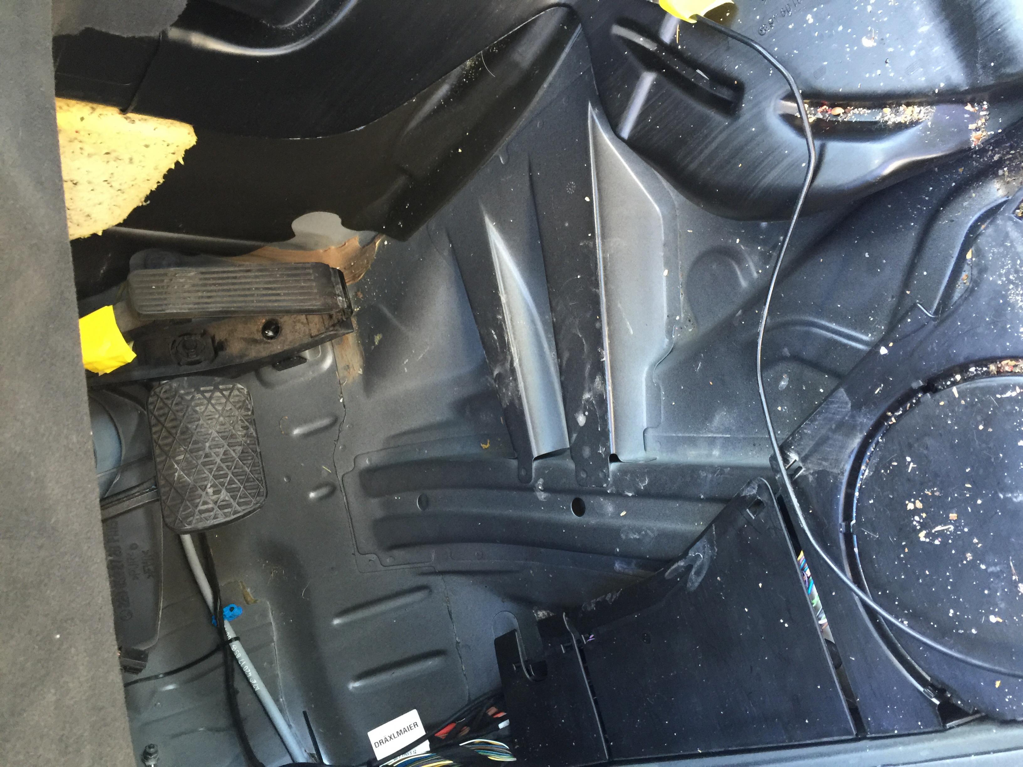

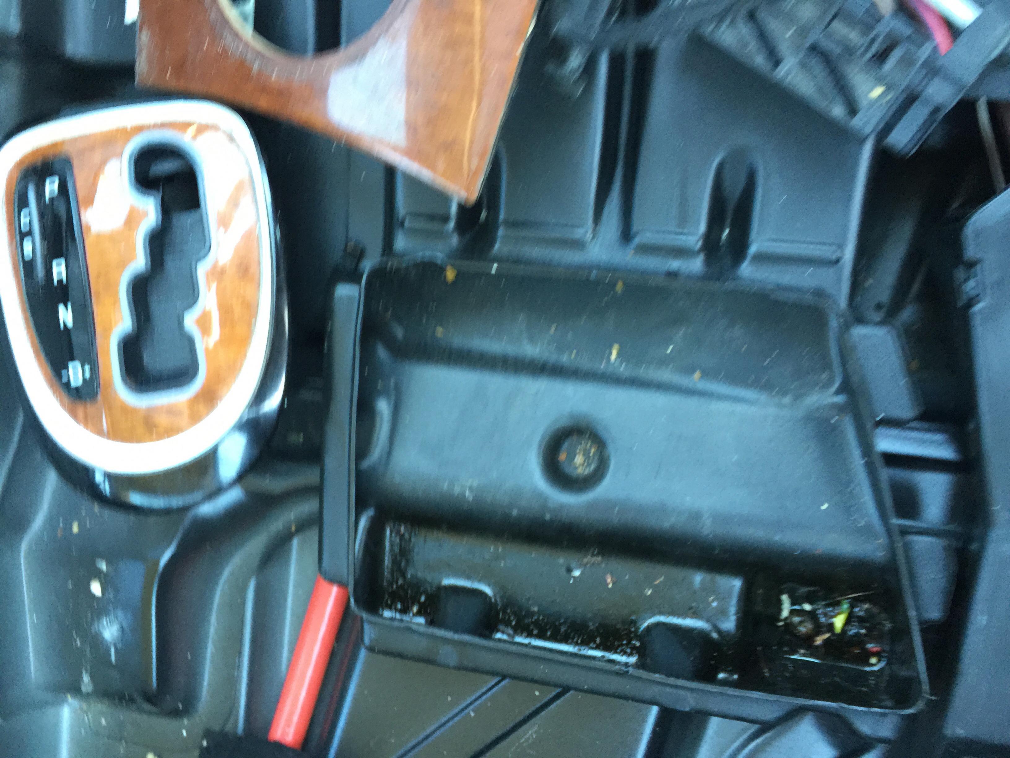

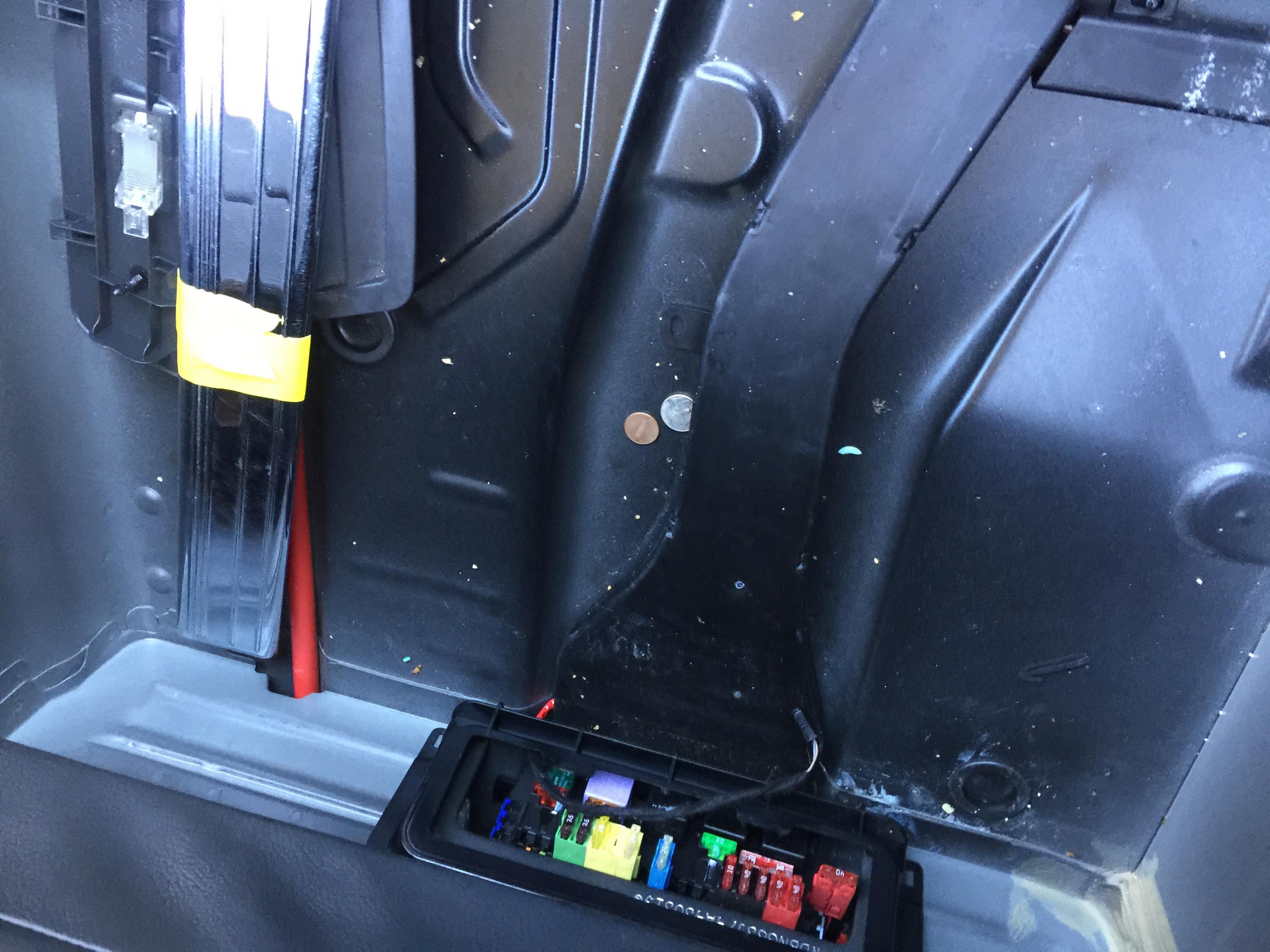

Some photos, after body shop removed the interior.
Attached Thumbnails 2004 S430 4Matic tail light stays on and kills battery-image.jpg

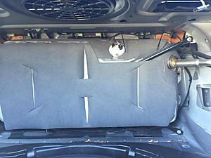

More

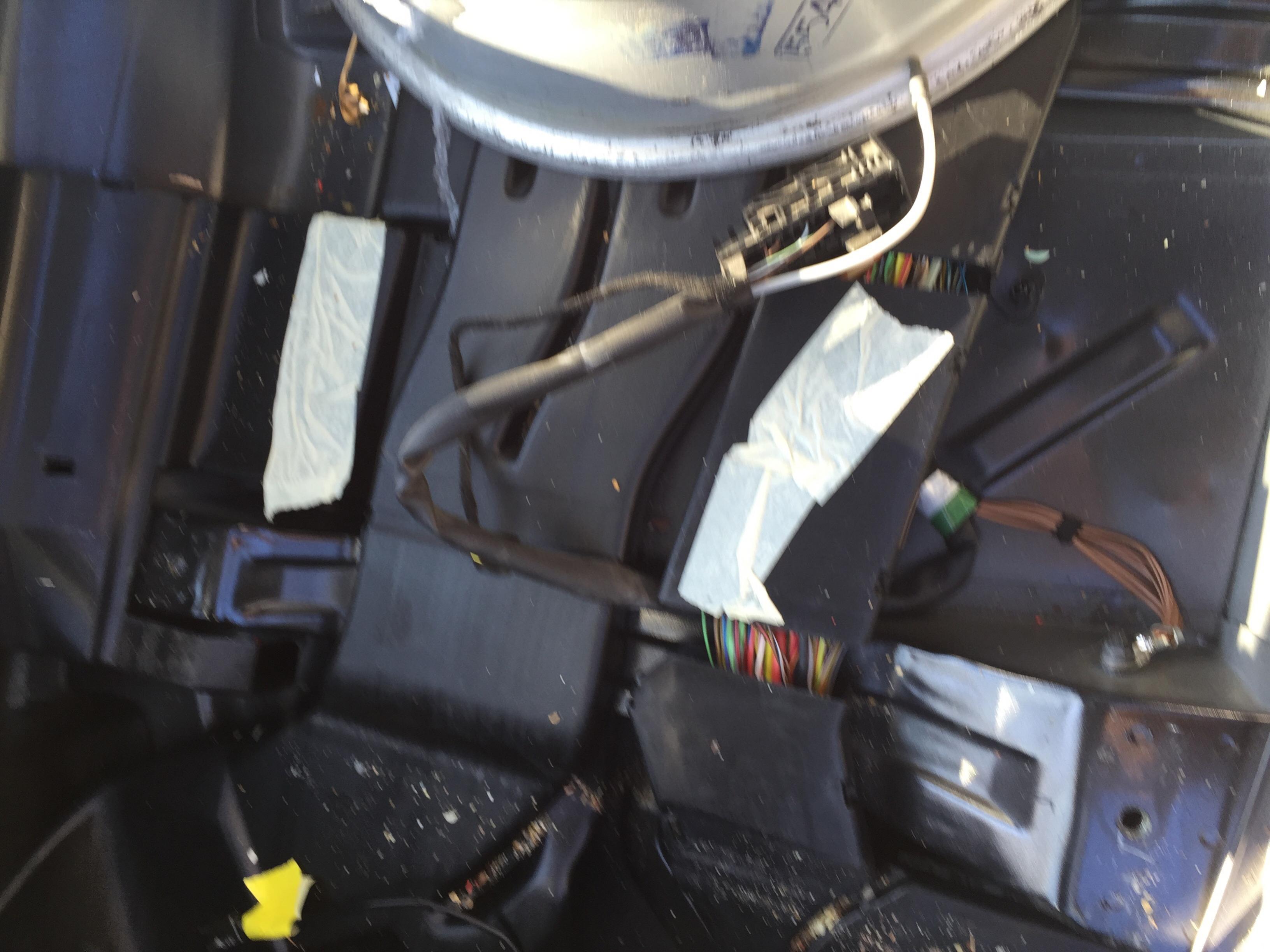

More

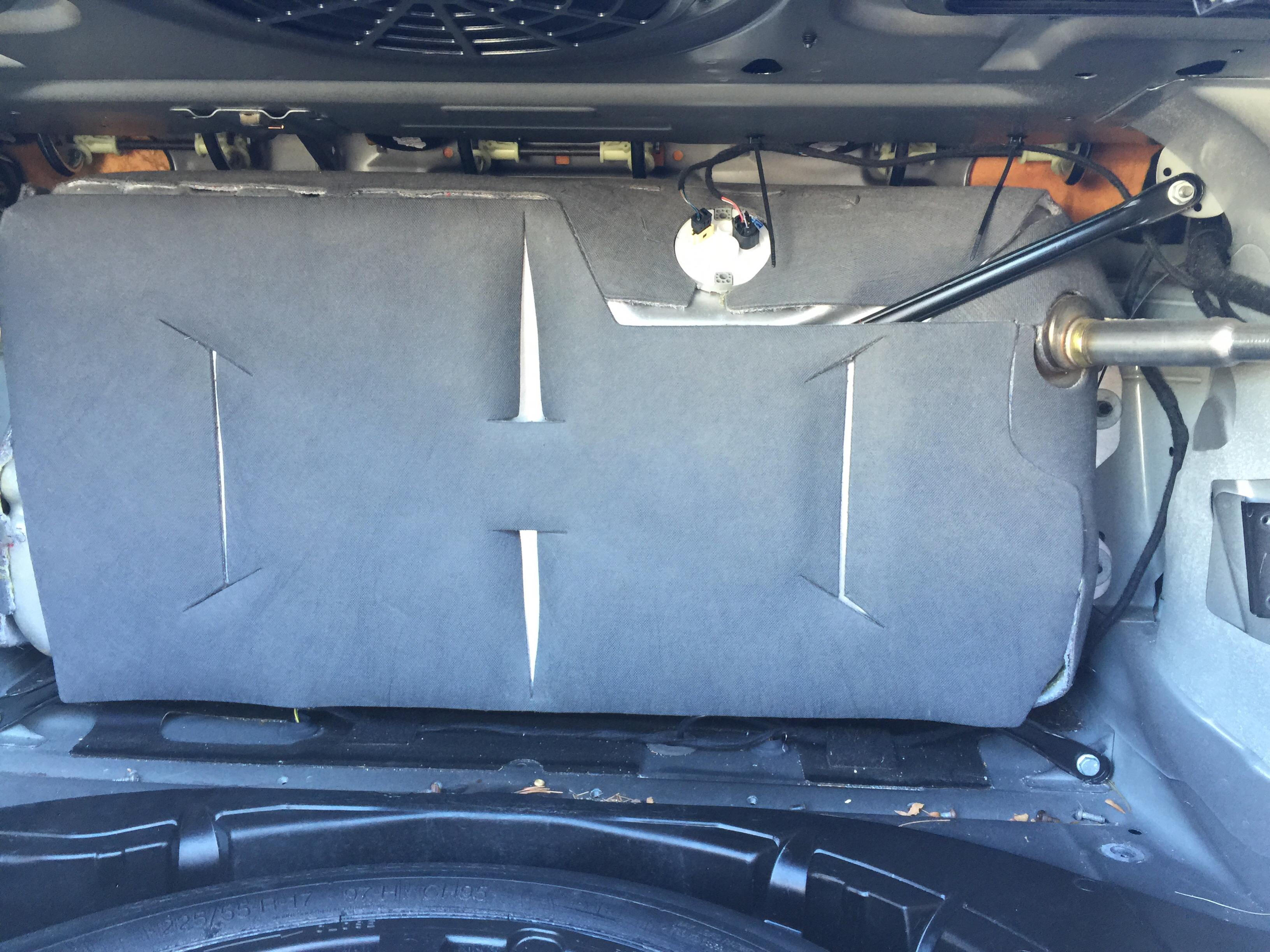

Plus

All these photos are with the interior out. No sign of water getting in from the front.

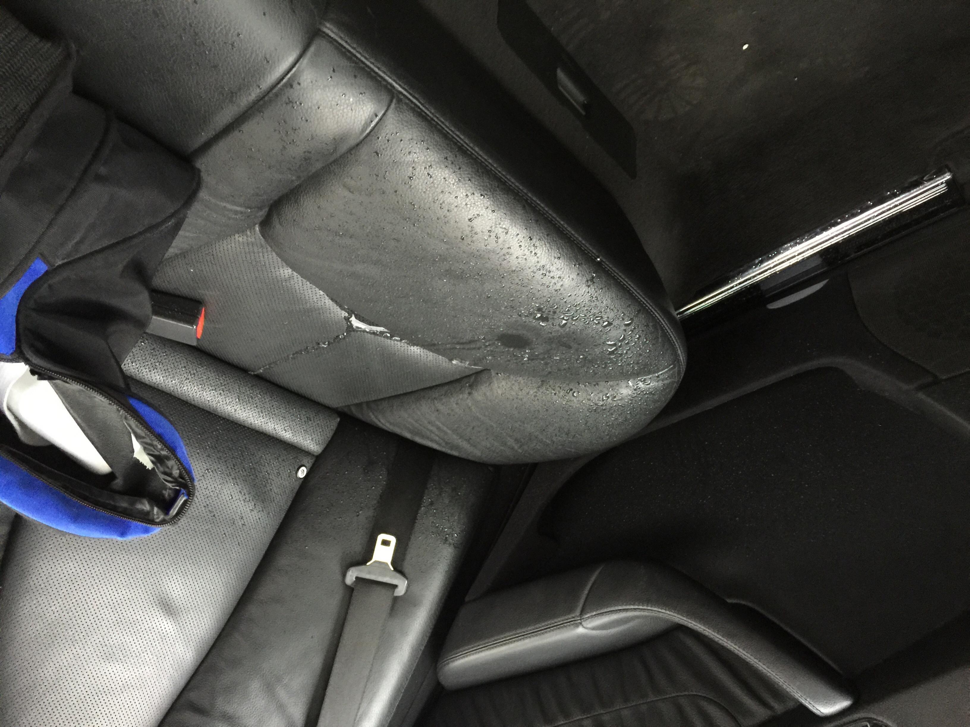

After about 2 hours of rain, I went and checked the car. The rear passenger vanity mirror was leaking like a sieve. Water all over the seat. Floor soaked again. So I figured that the angle of the car had something to do with it. I moved it into the garage, and the water stiopped leaking from the mirror. I dried off the roof and got a spray bottle of water. I sprayed along the seal of the sun roof, and could see water leaking from the vanity mirror.

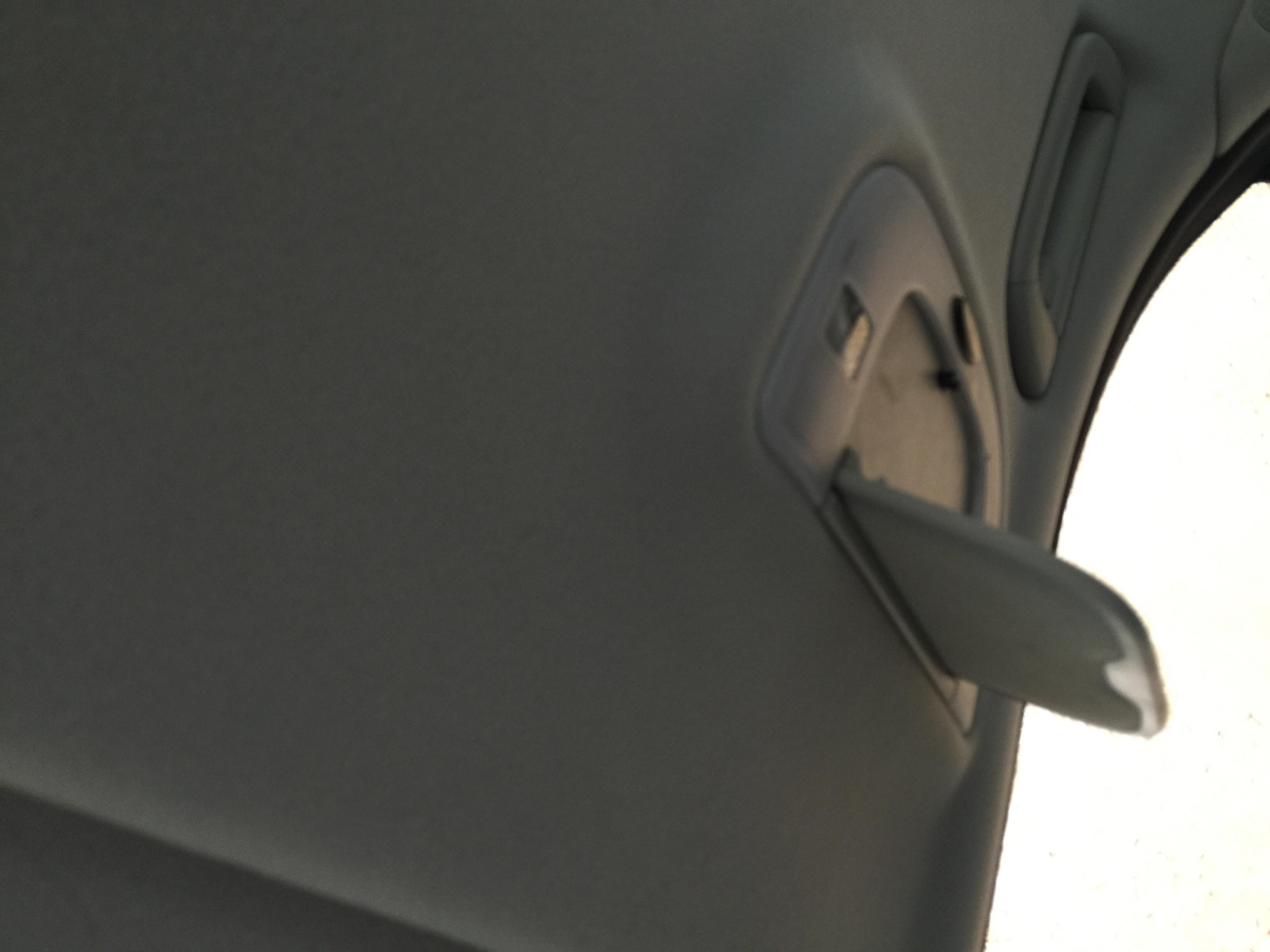

Leak from vanity mirror.

Seat

That's your sunroof drains

Used www.waterdoctors.com and the fixed the leak in 20 minutes, for $150. A small part of the seal, around the sunroof, came lose, and water was dripping, behind the seal and going right down through the vanity mirror.
Now, I'm wondering whether the seal came loose, from the accident, or if just a coincidence.
