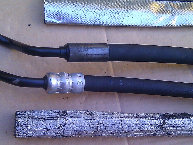

I was going to mention that the other really good thing you can do with ABC is protect the flexible hoses from heat in the engine compartment. Mercedes already shield some of them, but they ALL need it.
Here's what old hoses look like when they're protected (I cleaned the sleeves, but the hoses are as they came out) :
And here's an unprotected one from the same location:
So now I cover all the ABC hoses in the engine compartment with those metalised fibre-glass sleeves.
Nick

Front Splash Shield
Transmission cooling line
Replace transmission fluid again
Engine mounts
I have to say the car is slowly beginning to grow on me. The engine is fantastic, and the ride is impeccable. I'm really starting to notice the quality of the Mercedes. Many components are rock solid despite 190k miles. Nothing catastrophic seems to be wrong. The handling is also really good. I'm a little nervous about the pneumatic lines and the PSE pump as two of the soft-close doors have already stopped working (I know the pump does this on purpose).
I really hope I'm able to take care of everything that needs to be taken care of, and then have a reliable car for another 100k miles.
*Is there information on which spark plug wire length goes on which spark plugs? I think I mis-guessed as my third coil from the front on the right bank the forward wire seems a bit stretched and tends to pop out.
