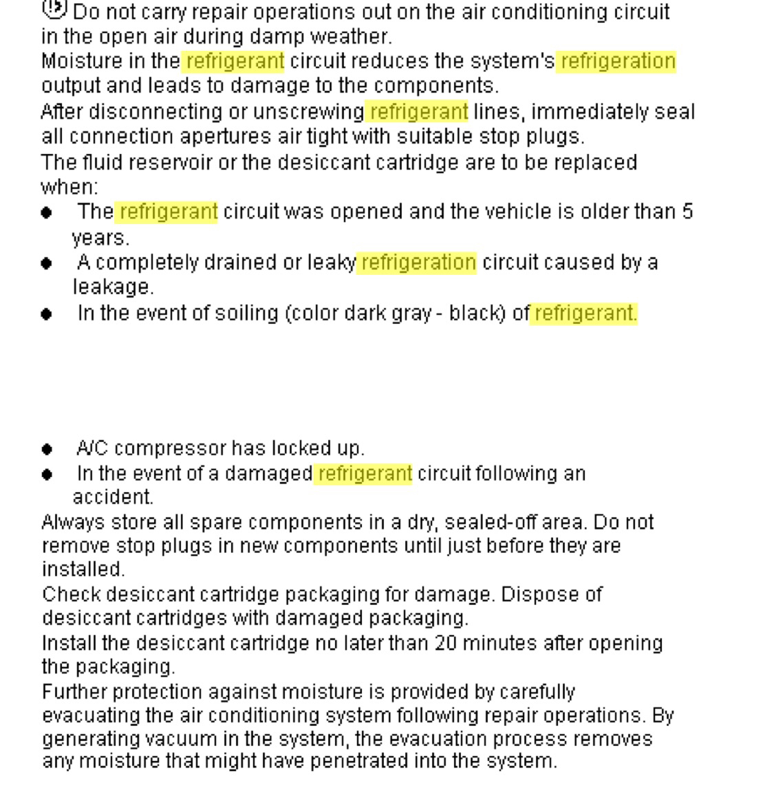

WIS talk about replacing the drier every 5 years and 10cm3 oil refill. Is this what's needed on PAG 46?

Once the refrigeration is gone, you need to replace the receiver/drier, evacuate, and refill. Not a DIY job - and I'm the first to advocate DIY everything. .

Some generalizations - YMMV.
If you lose the refrigerant from a slow leak, you will lose very little of the oil, will probably not need to add any.
If you lose the refrigerant from a very fast leak (e.g., blown hose), you will lose much of the oil, and will need to add an unknown amount.
If you change components, you will lose some oil with each component, and will need to add some oil. This is what is referred to in the WIS page shown - and yes, 0.034 US ounces is the approximately correct conversion. (As an example ONLY -do not use for the W220! Porsche says that on a 928, the oil is approximately distributed: compressor - 40%; evaporator - 35%; condenser - 15%; receiver/dryer & lines 10%.
Only if you change the compressor and flush the rest of the system will you need to add the total amount of oil. You must determine how much oil is included in the compressor that you procured!
In the USA, a certification is required to purchase most refrigerants, but not R-134a.

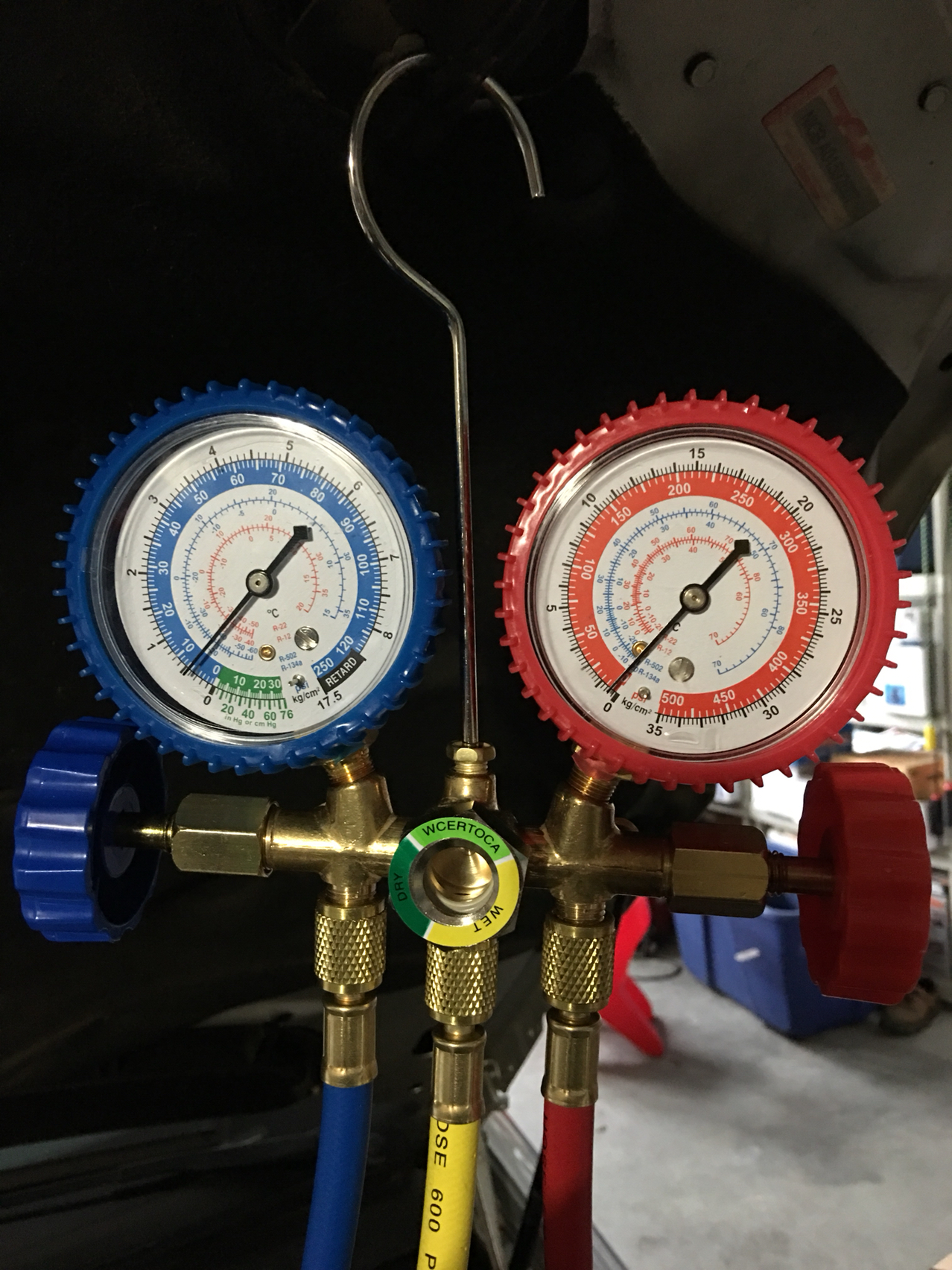

I went ahead with 3 cans of 12oz and 25cc of PAG 46 last night. It was a fast leak and I didn't know how much were lost. Don't ask me how I knew about the leak.
Here's the pressure level before the pump down
a/c recharge-photo248.jpg
It took about 6oz of refrigerants for the compressor to kick in and I got 42F air blowing by the time the 1st can went empty.
People don't normally respond to AC refills until the system is no longer blowing cold air. With 1/3 of capacity, the system works much harder and that isn't good.
