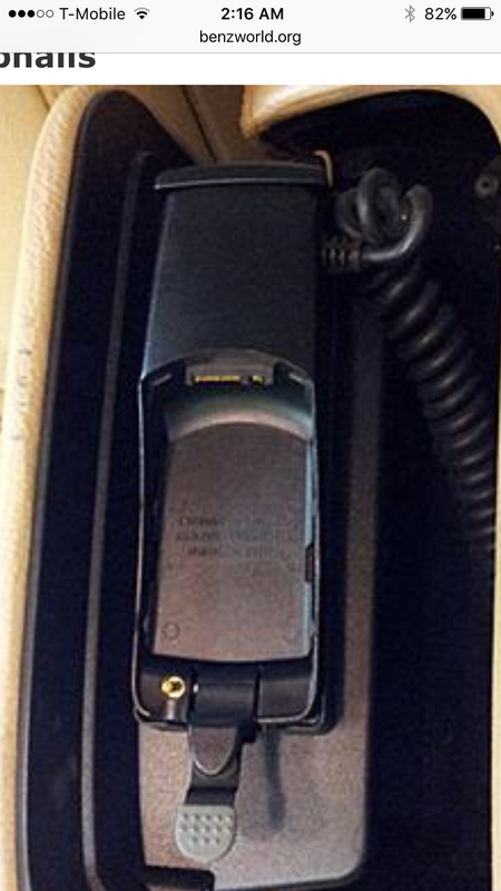

If you have the cradle in your console
which Bluetooth module do I need for 05 S600?-95f7c8a9-56b1-4b44-a897-05847116b824_zpsps2gjcqq.png
you need the Mercedes Motorola Bluetooth puck B67875856

I don't have that exact cradle but I have a slot for it with a plug and all
