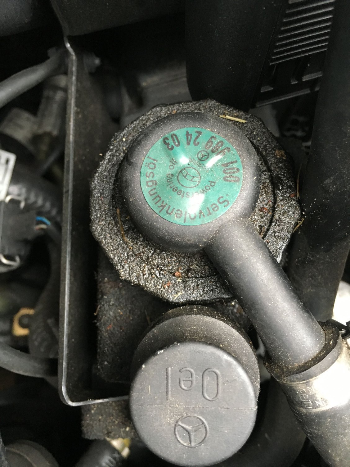

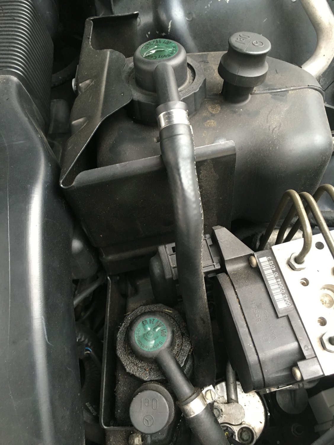

The fluid in the reservoir closest to the front of the car is low. What type of fluid do I need to put in?

Pentosin. Chf11s
Sold at many auto parts stores

Sorry it's a 2002 s600, will that fluid still work? Thanks!!

You need to use Pentosin. I recently flushed my system and purchased it from Amazon.

yes
Also, you may want to really clean up the area around the reservoir, the system is very sensitive to any kind of dirt particles.

The cap was loose, and it looks like the fluid leaked out. Do I need to use anything in particular to clean it? Thanks again for the help!!

That's a drag, hopefully nothing got in while it was open. Any kind of cleaning material is fine, but more important to make sure the seals/caps on the reservoir are on really tight while you're doing it so nothing gets in.

Or an accumulator popped and blew out the fluid.

Our ABC cars have nitrogen filled accumulators and when they fail they blow fluid out the reservoir. Mostly easy to replace and certain ones are more likely to fail. Check out the encyclopedia. Lots of info.
