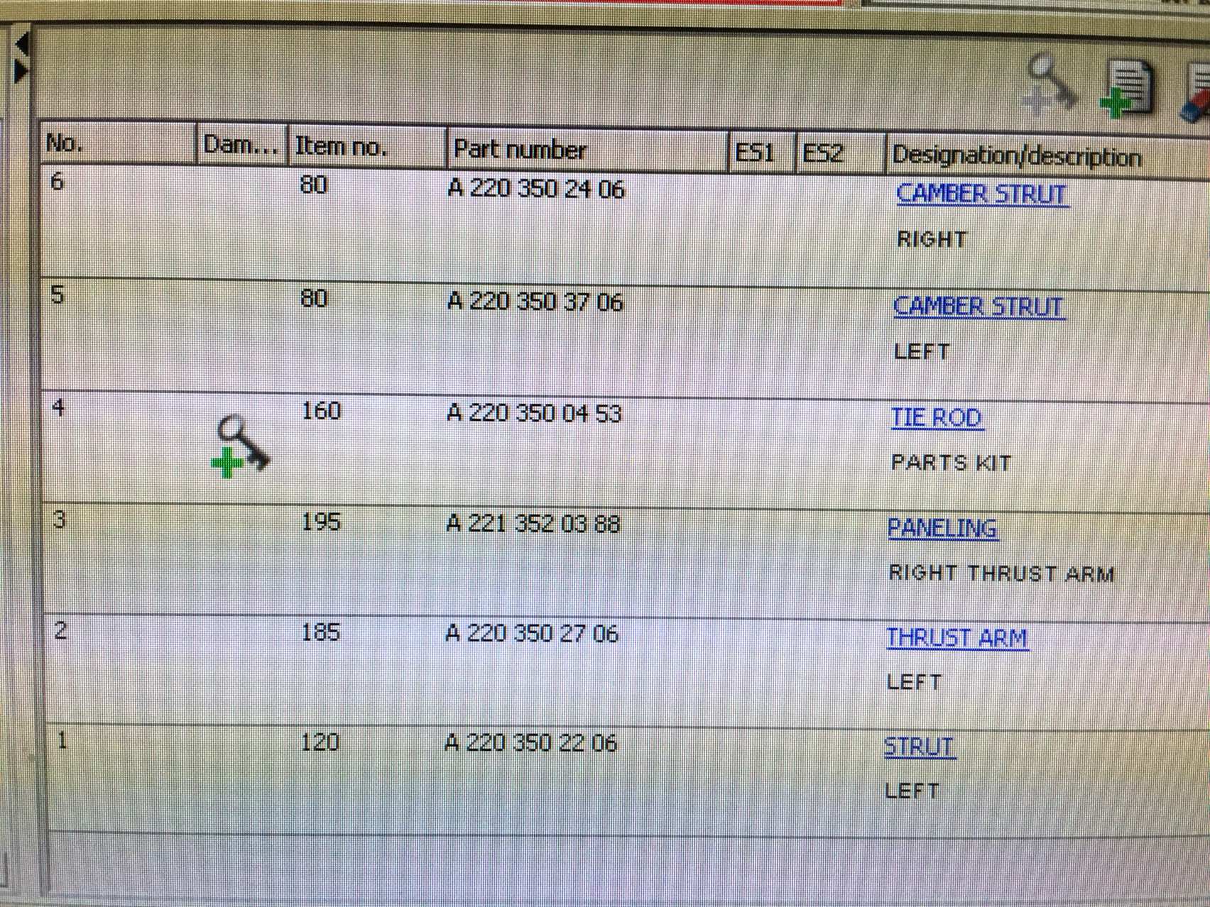

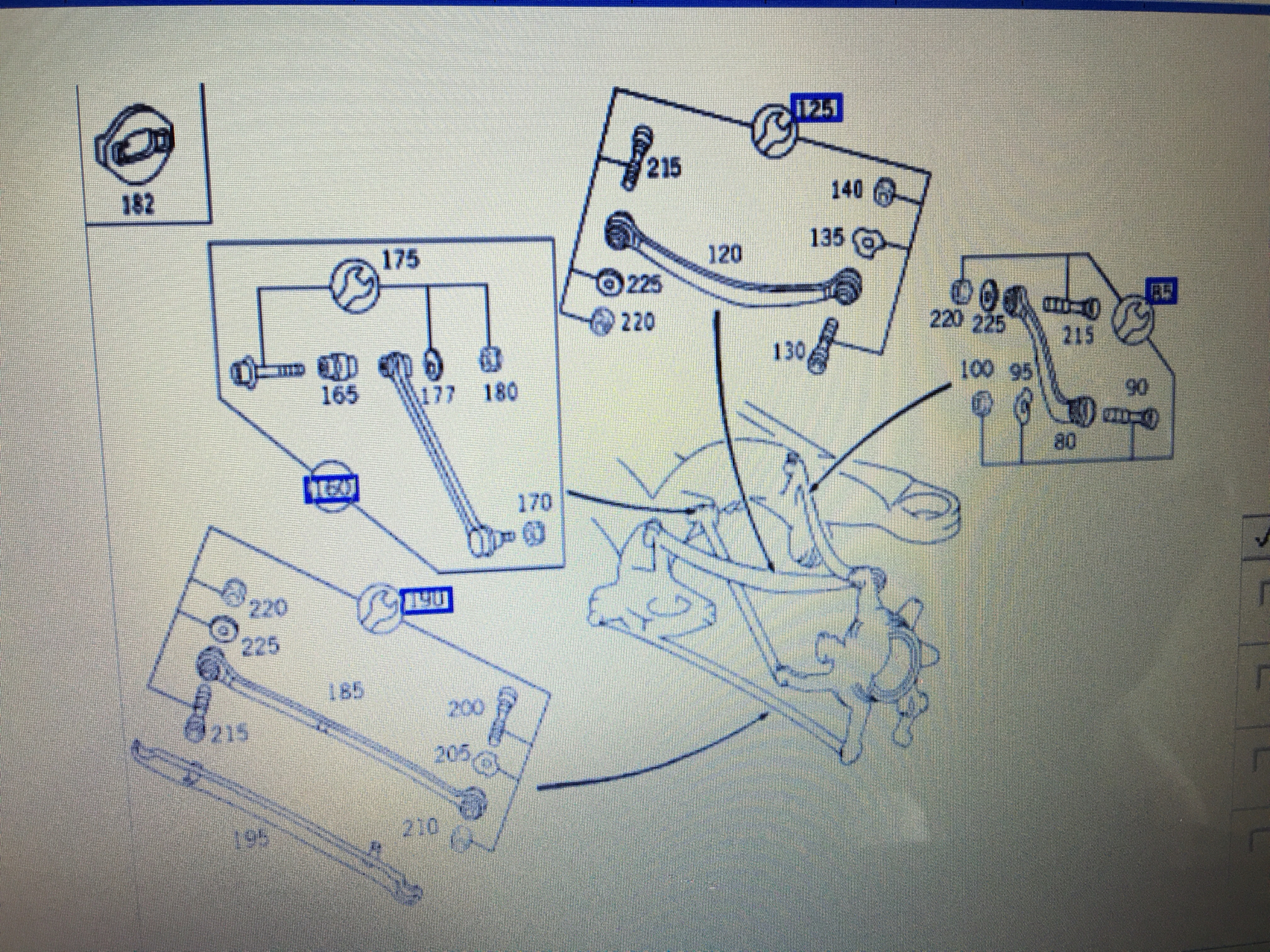

I was looking up the source for knocking sound and pulled these part numbers. They are for a 04 S430 non 4MATIC.

Picts
