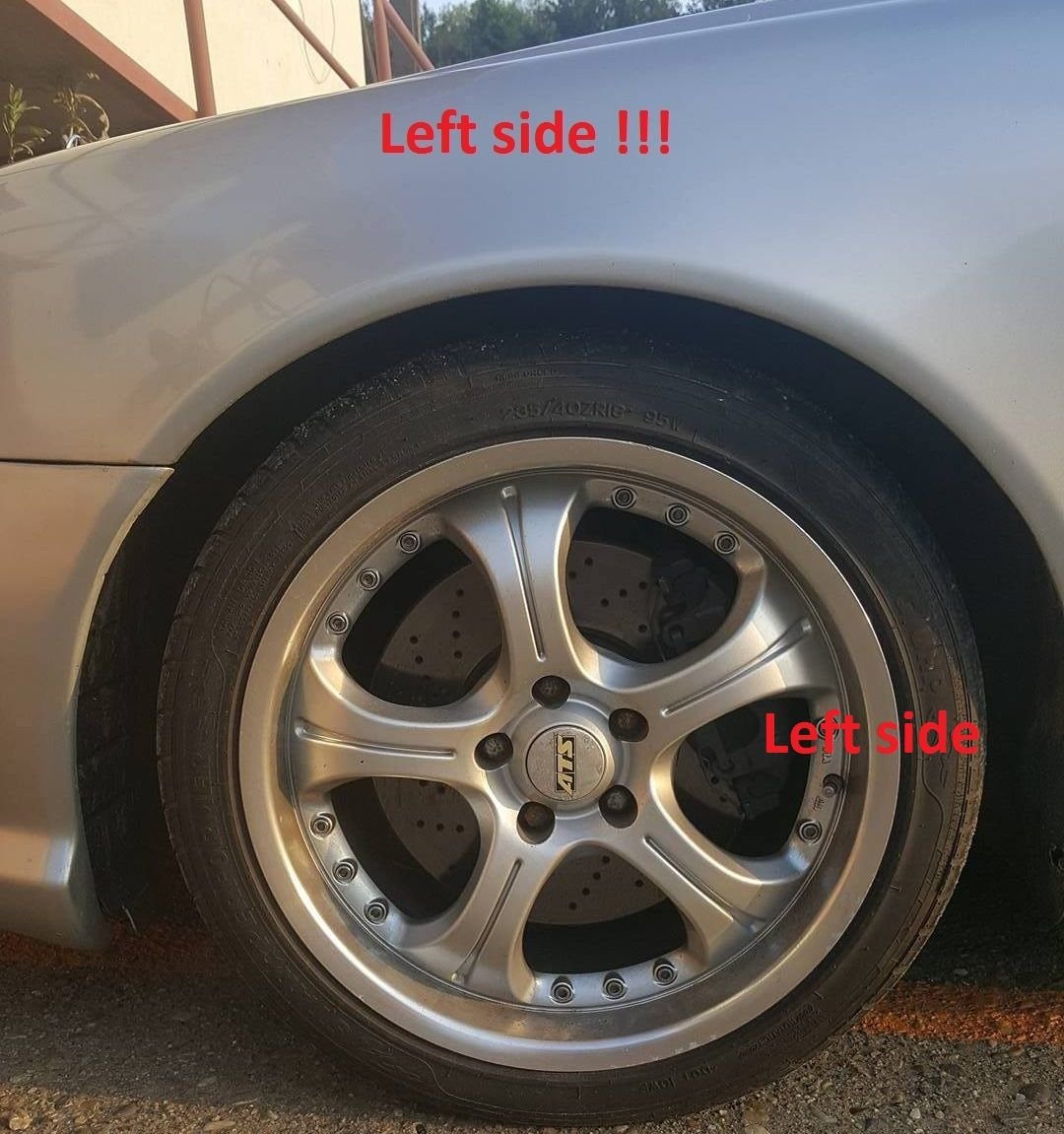

Update: after 3 days of not starting the car,i just realize that the front left side of the car is very easy to push it down and up,it easy to balance the car but the front right side is very stift,i cannot push the car down,and the front right side is higher than the left side with 0.5 inch.

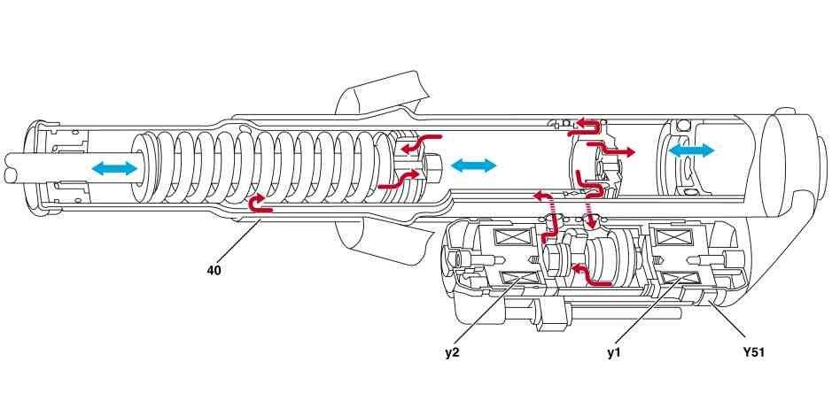

I found this in a W220 Encyclopedia.Maybe i need to replace y1-front axle solenoid valve 1.It this possible,to replace it,is anyone who has replace this?
Design
Y51 - left front axle damping valve
y1 - front axle solenoid valve 1
y2 - front axle solenoid valve 2
p - piston reed valve pack

As you found C1322 indicates that the valve inside the strut (damper) is reporting a problem.
First, carefully check the electrical connector from the strut that plugs into the body in front of the strut. It is not unusual for that connector to be inserted wrong.
If there is no problem with the wiring or connectors, you may have to replace the strut, as the valve is not available separately.
