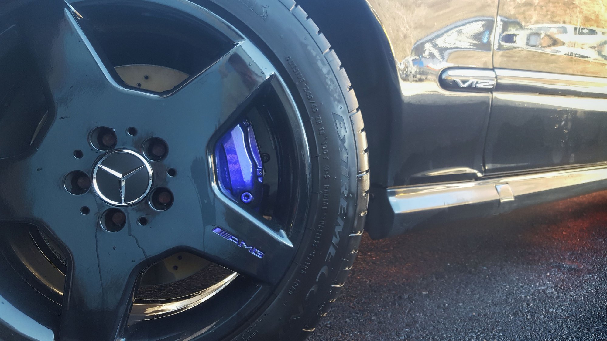

I like the blue calipers and lettering, nice touch. Those quick pulls are impressive, good enough to surprise a few people. I had a guy in a Continental GT try to get frisky with me on the freeway the other day, he wouldn't even look at me after that beating. You guys do great work, it's good to see people taking the trouble to bring these cars back. There's not enough of them to spare.

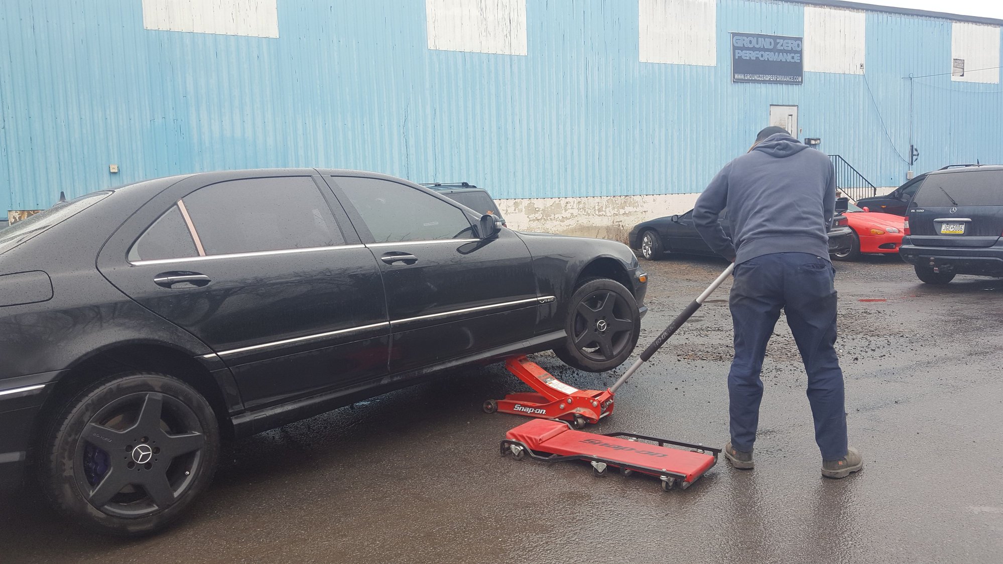

4 months of driving and we had our first issue since putting the car back together. Last week the transmission decided it wanted to act like it was in neutral all of a sudden. Thankfully, this happened right in front of my shop. A quick reset of the adaptive transmission program and it was able to drive onto one of my lifts. First thing we noticed was a high fluid level in the transmission. I found that odd since we have serviced the transmission ourselves and I was sure the level was proper. Then, I thought back to a month ago where the low coolant level light came on. At the time, we were on a road trip, so I just added some water (about a quart) and we went on our merry way. After seeing the high transmission fluid level, the issue became clear. A faulty transmission cooler in the radiator. So, with that, I ordered up a new Behr radiator, Mercedes coolant, and transmission fluid/filter. While in there, I finally installed a rebuilt suspension solenoid block in the front to fix the sagging front left strut that we would experience when sitting overnight. Everything is back in and working smoothly again.
I am pretty sure one of the turbos is leaking oil out of the turbine. I'll have to pull the downpipes to confirm. I'm not surprised, as it seems to have a bad catalytic converter. But, it sounds like forced upgrades to me.
