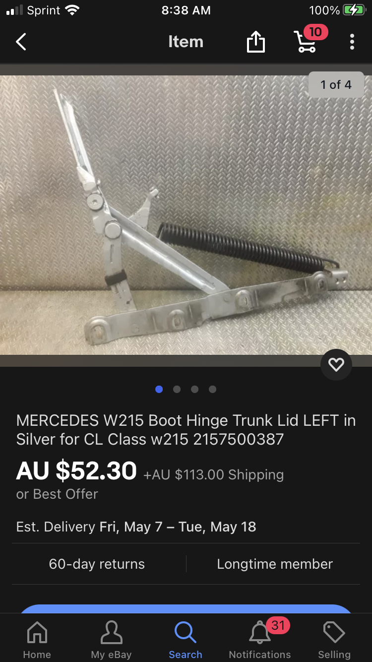

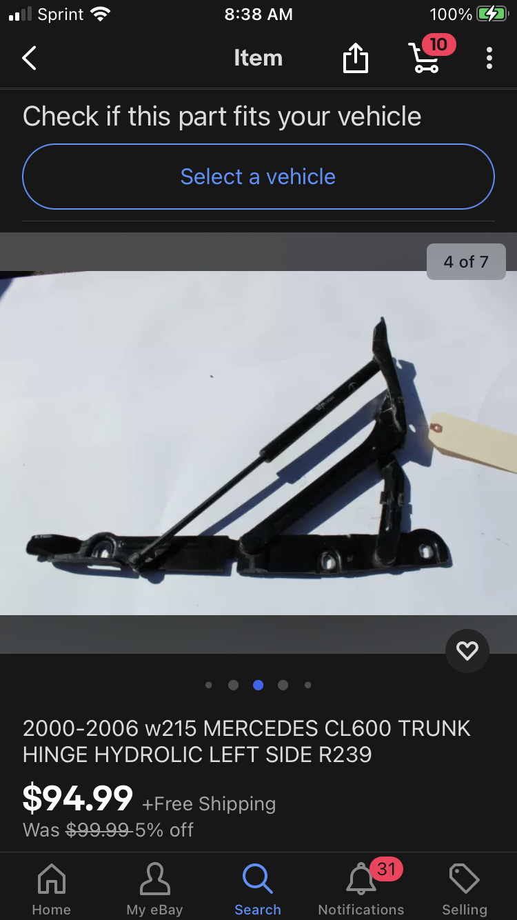

Old May 3, 2021 | 11:40 AM
tusabes's Avatar
Joined: Jan 2008
Posts: 6,150
Likes: 533
Mercedes
Here are the two styles , the style with the spring is for the cars without the power trunk closer
