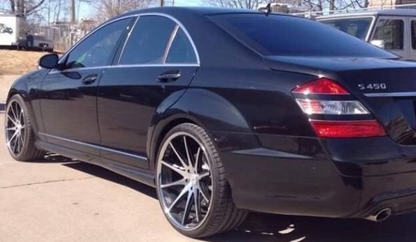

hello,
Saw a set of 22" rim with front by 245x30 and rear 295x25 onS450.
They look very nice but I believe the speedometer will be off.
Any experience on this kind of external setup? Particularly with ABC?

I understand the hassle but they do loook very nice and seems okay from distant looking.

Oh. I realize my mistake.
The picture is from S450. Not sure is 221 but definitely not my S55.
