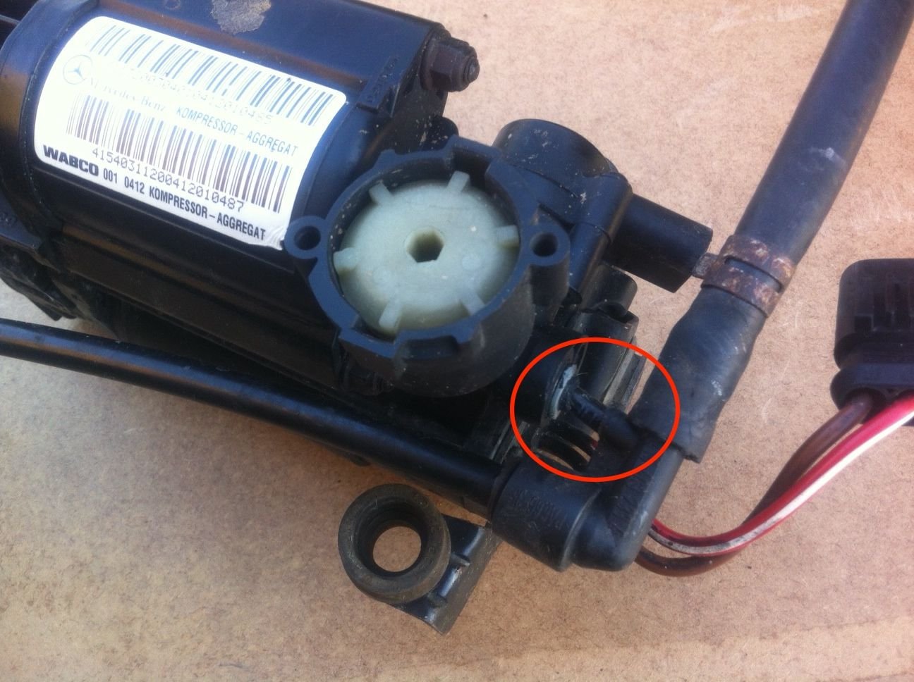

Hi,
I took the compressor out today, and noticed, that one line is broken, and has been attempted to repair by previous owner. As I understand it's pressure relief pipe, so I shouldn't worry about it?

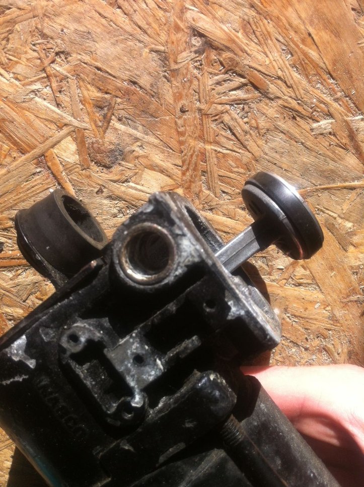

So I took apart compressor, and what I've found out is that pressure hose was previously butchered in place. I see that, I could by only hose for like 9Eur, but the problem is that factory connections where this hose has to be fitted is permanently damaged. The hole in the second photo was completely clogged, so I had to drill it out.
