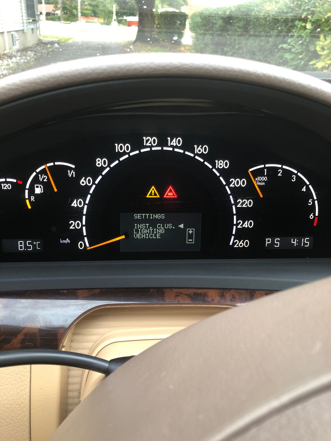

Thanks for help but when the car is off I have no problem controlling the lights in any position but when the car is running all the lights come on when it should only be the DRL. I went through the menu like I saw on YouTube but I don’t have Constant,AUTOMATIC OR MANUAL option.

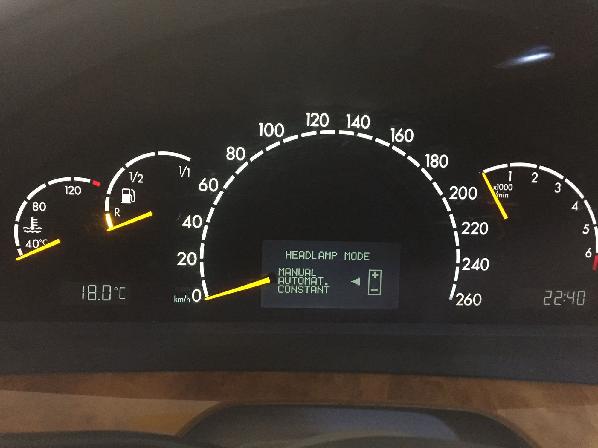

Select settings (left lower steering wheel button) select headlights (left upper steering wheel button) then you'll find the 3 options "manual. Automatic and constant". Select the mode you want by pushing the +/- button (right upper steering wheel button)
I don’t have that option. I can only adjust the delay of the headlights and interior lights

With changing a country code by star diagnosis it might be possible, but due to the highway safety regulations, it could be illegal changing the code, and you may loose the license to operate and register the car. Attached pictures of the European menue
