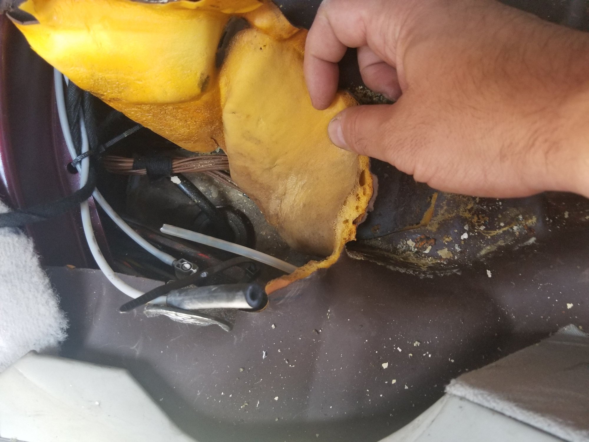

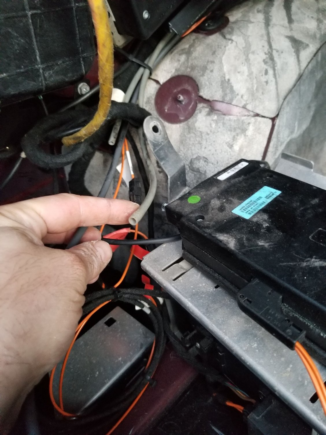

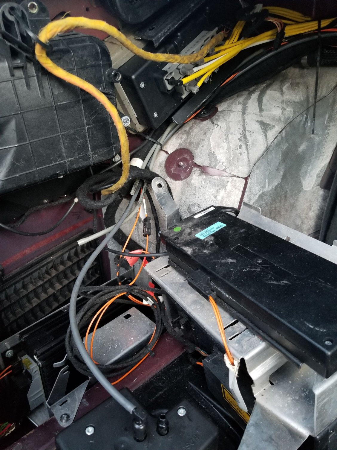

Hello everyone, so i recently had someone work on the soft close system on my 2003 s600. Unfortunately this asshat up and disappeared on me in the middle of the job and left everything in pieces. I'm going to end up taking it to a different shop in the end to have it fixed properly but i was hoping someone on here could help me sort out the mess before i spend crazy $$ in diagnostics. A few of the hard lines have cracked due to age and all the connectors are missing. I've put up a couple of pictures so y'all can see what im working with.
The first 2 are in the trunk area. The pse pump functions fine and nothing is cracked there. But there's a few lines under there that are cracked.
The last picture are 2 lines under the rear drivers seat. No idea where those go to.

these are 4 mm nylon lines, and can be fixed by either replacing them, or just connecting them with flex hoses or heat shrink hoses, possibly with already applied glue. The lines behind the rear seat most probably belong to the headrest actuator
