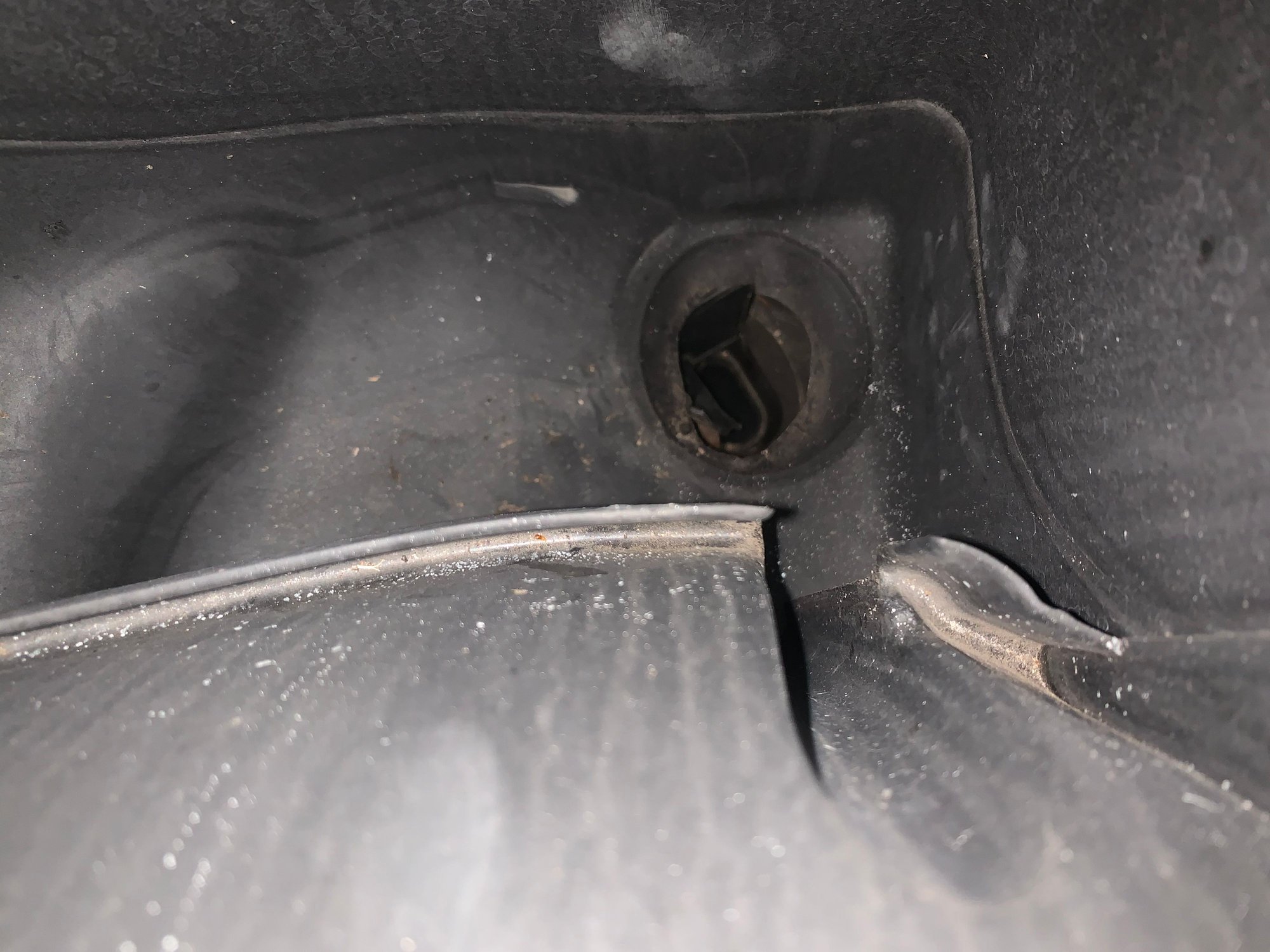

Open the hood. Look at the large black plastic air intake grille under the right corner of the windshield. Use a flashlight to look thru the grille to the bottom of the funnel. If the small drain hole at the bottom is not perfectly clear, make it so.
If the drain is clogged, rain or wash water will fill the funnel, then spill over into the passenger compartment under the carpet and padding. There will be no visible signs of water, but the water will fill the recesses under the carpet, damaging the main power leads and connections, then travel under the carpet to the area under the rear seat, where the rear SAM (Signal Acquisition Module) is installed, causing serious electrical problems.
Yet another problem that is quick, easy and free to prevent, cheap but a bit of hassle to repair DIY, very expensive to have fixed.

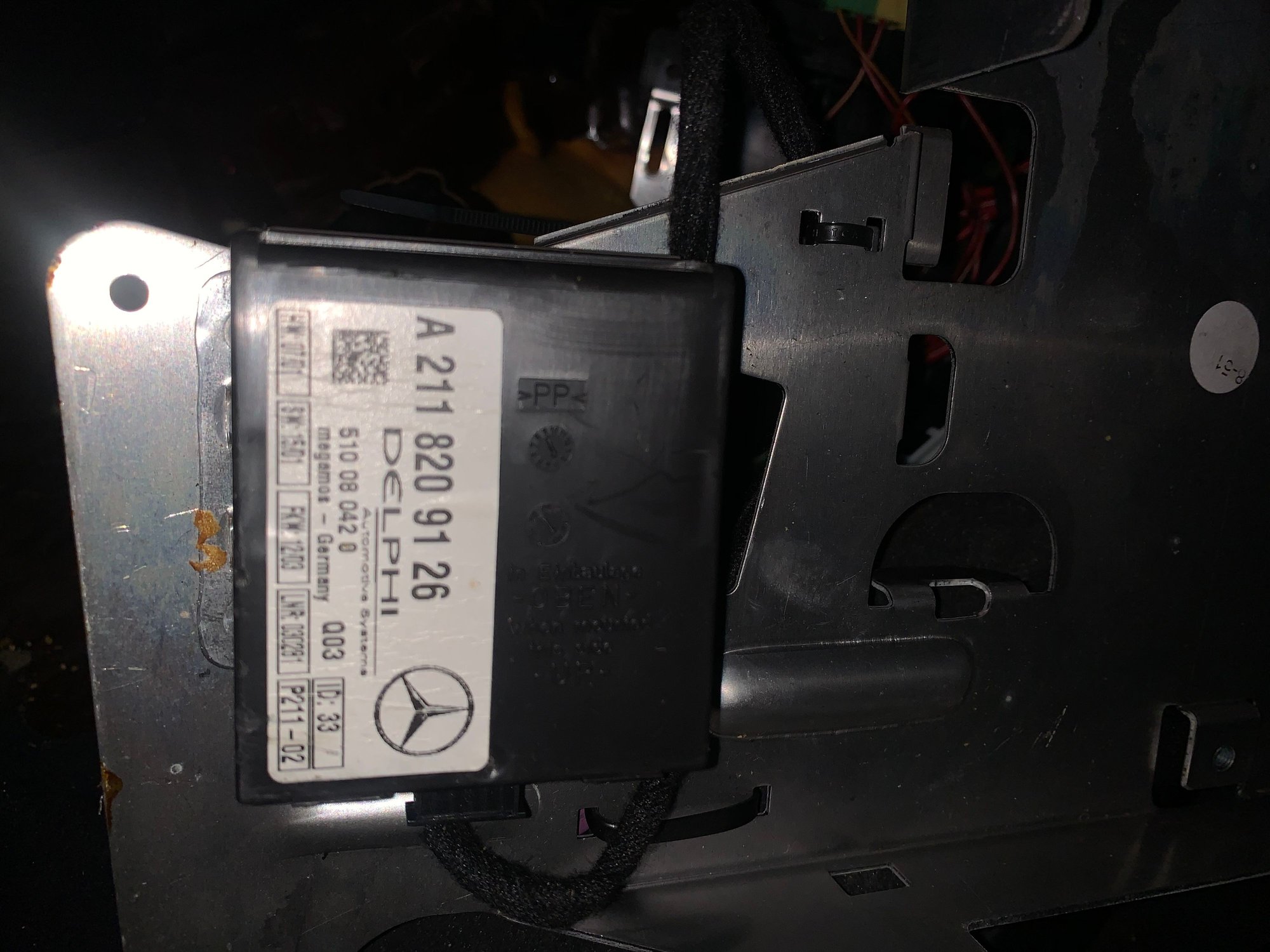

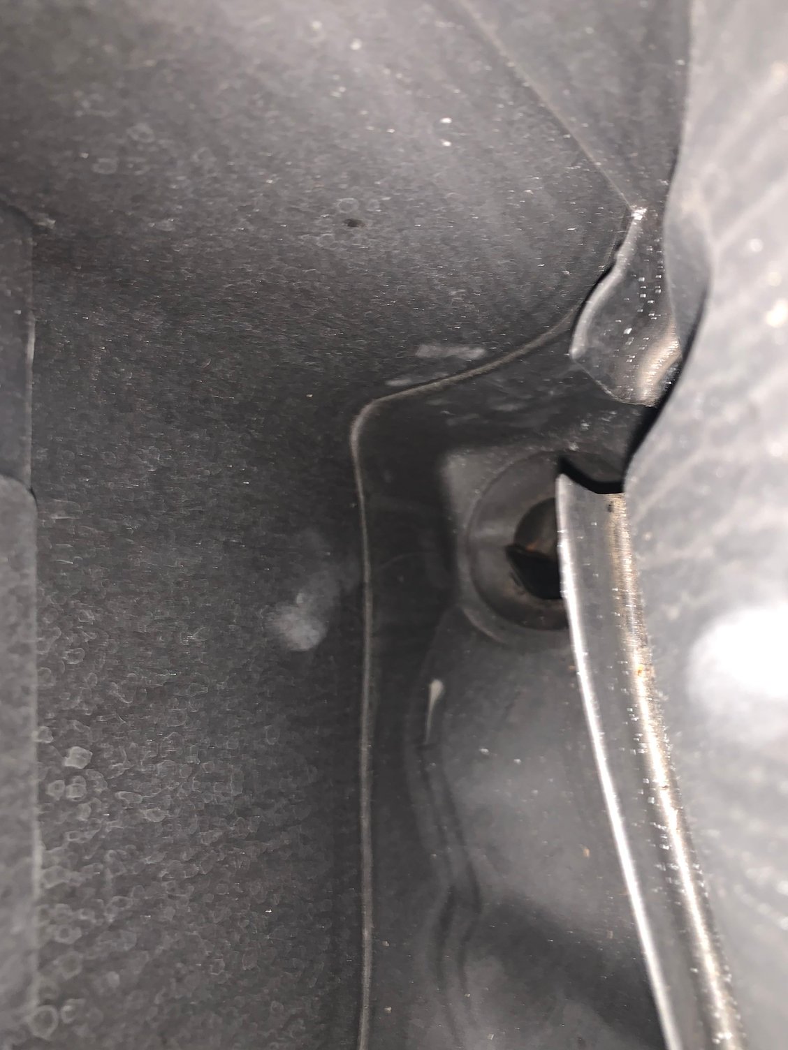

Got the car back!!! Okay, so I should check the numbers on the SAM to see what I need to buy?
I remember a bit of water spilling on that back seat a couple months ago. I thought that is what messed it up.
I need steps on possibly fixing the door locks and getting a new SAM. I think that is it.

Take off the rear seat bottom and get the part number on the sam . Find same part number on eBay and buy it
the sam gets water damaged from the clogged Reed valve in the engine compartment that allows water to run under the carpeting all the way back . It is a very common problem and if you don’t clean out your Reed Valve now it will happen again and damage your new sam next time it rains
Wally posted detailed info how to clear your reed valve. And here is a video showing you exactly what to do

Old Sep 16, 2020 | 09:13 AM
Jpleas's Avatar
Joined: Sep 2017
Posts: 41
From: Birmingham, AL
2003 s500 (W220) Base
UPDATE!!! UPDATE!!!

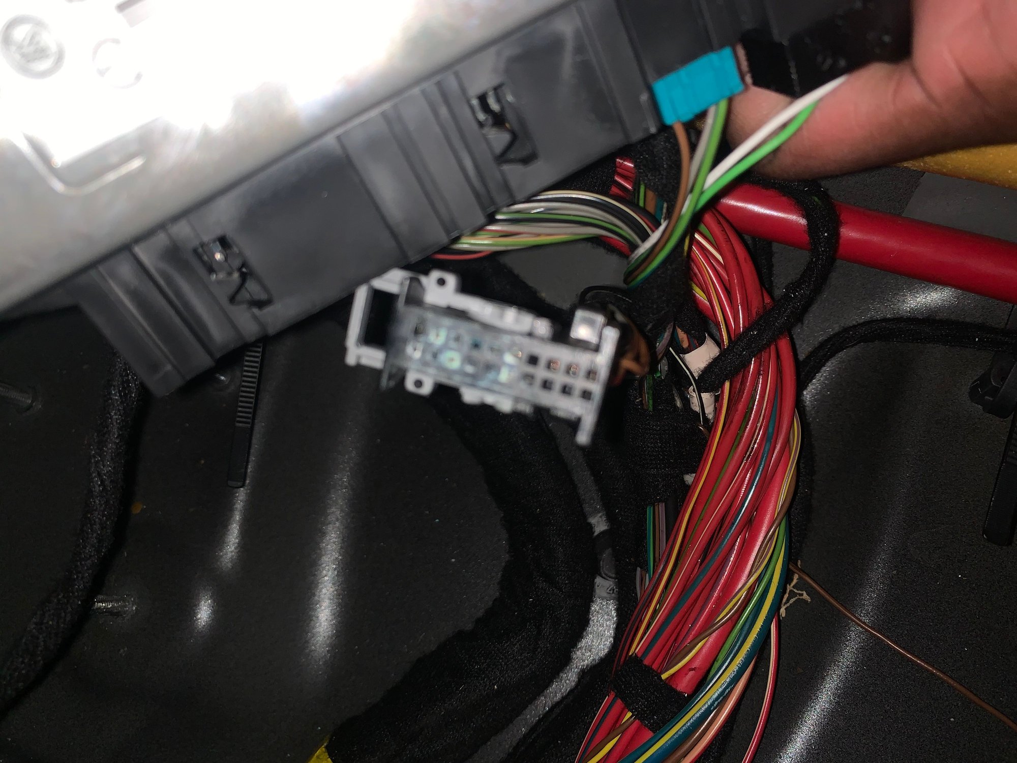

I checked under the cowl in the engine bay and it was clean. I assume the mechanics cleaned the Reed Valve.
I also got the numbers on the SAM and have pictures of the corroded/water damaged harness that they "think" is causing the problem.
I put the SAM numbers in eBay and it brought up a ton of options. I just want to know which one is the best to buy that will be just a plug and play.

First I would try deoxit cleaner and a toothbrush to clean the corroded contacts , that might fix it
if that doesn’t work here is the cheapest rear sam , it’s in Latvia though but you are covered by eBay guarantee if it doesn’t work
be careful some people have the front sam listed when you search the part number for the rear

Crc makes a cheaper electrical contact cleaner at $5 but deoxit is better at $12. There is no way to predict if just cleaning the connections will fix anything, or if the sam is damaged or shorted internally , but you need to clean the harness connections regardless before you fit a new sam. So you can’t skip the cleaning step .
the harness very rarely gets permanently damaged , as long as you clean the harness connections it should be ok - but with that much corrosion it’s likely the internals of the sam shorted out , so a thorough cleaning plus a new sam should fix your issues
