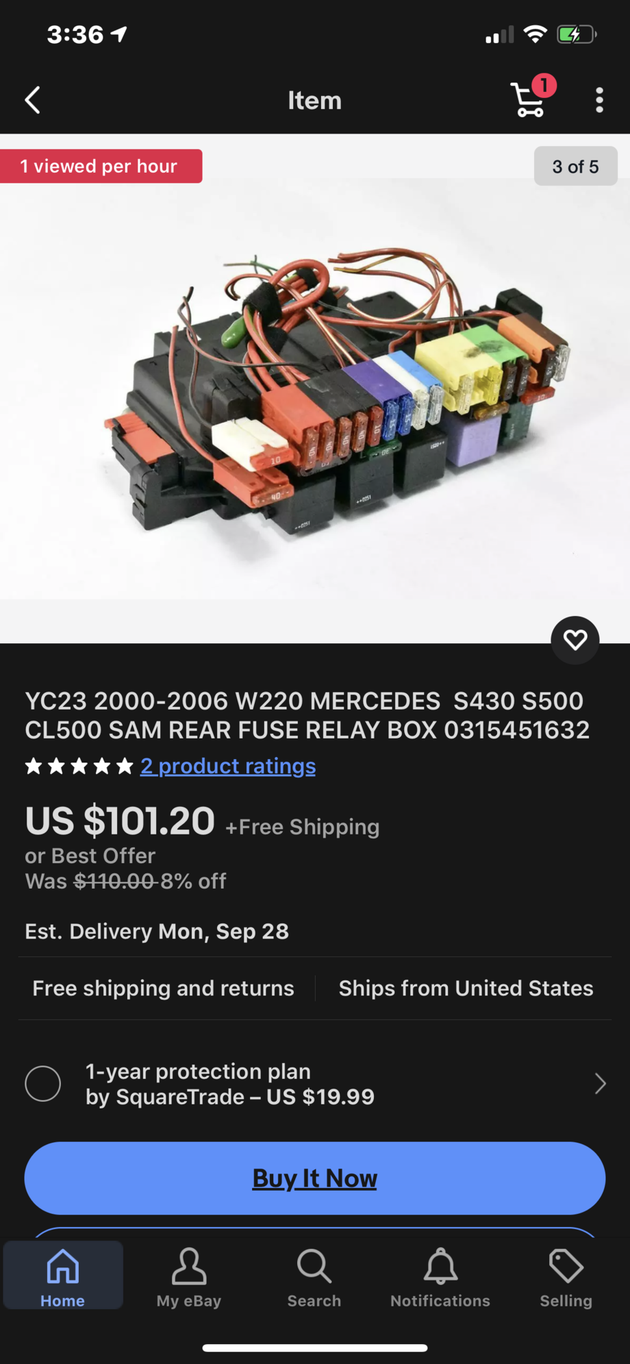

So I found this one on eBay, but the description says "CL500" and says its for a s430. All the number match up.

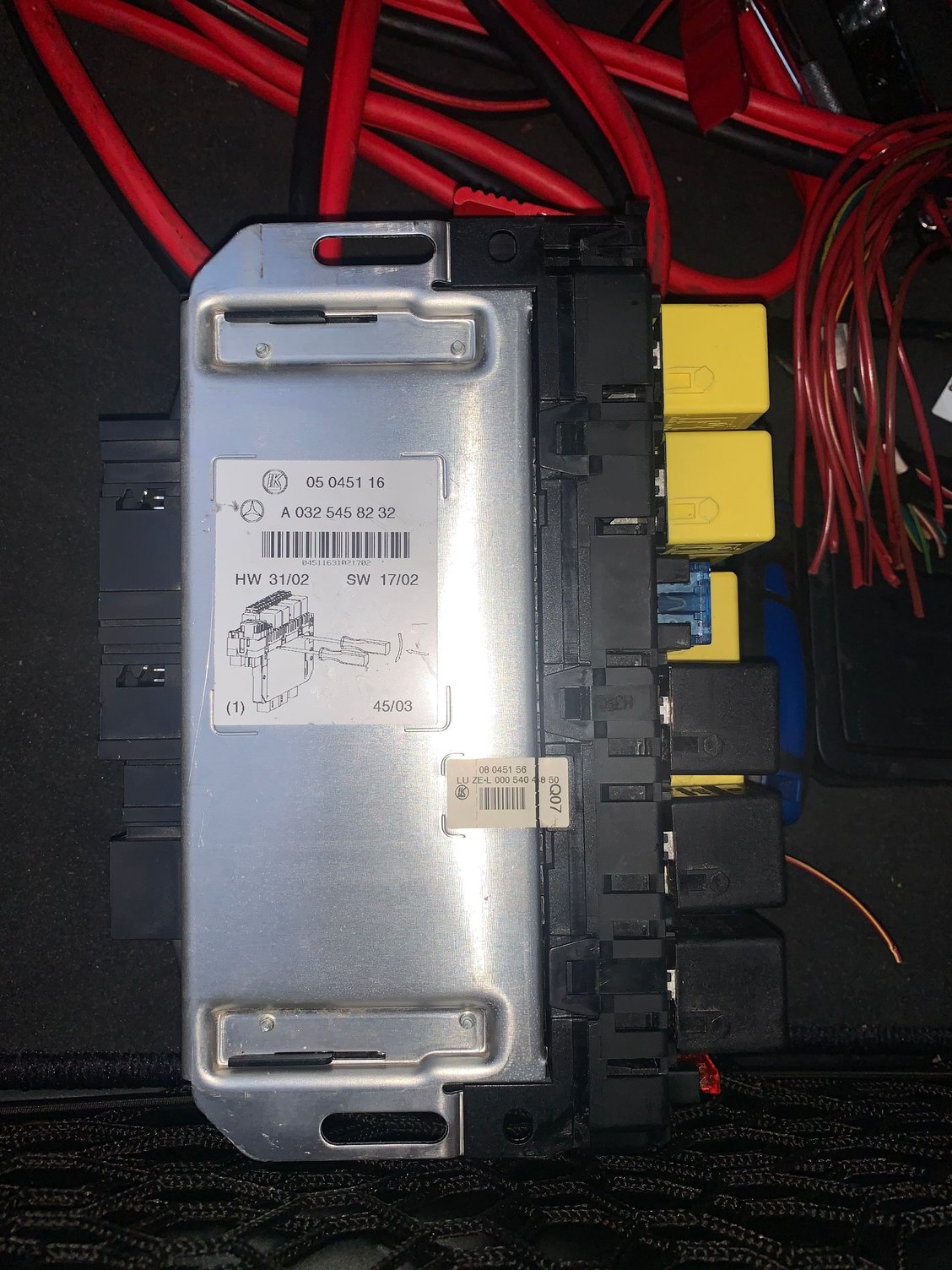

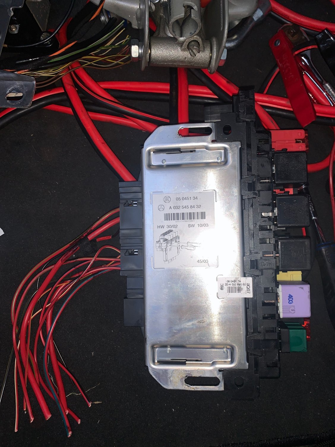

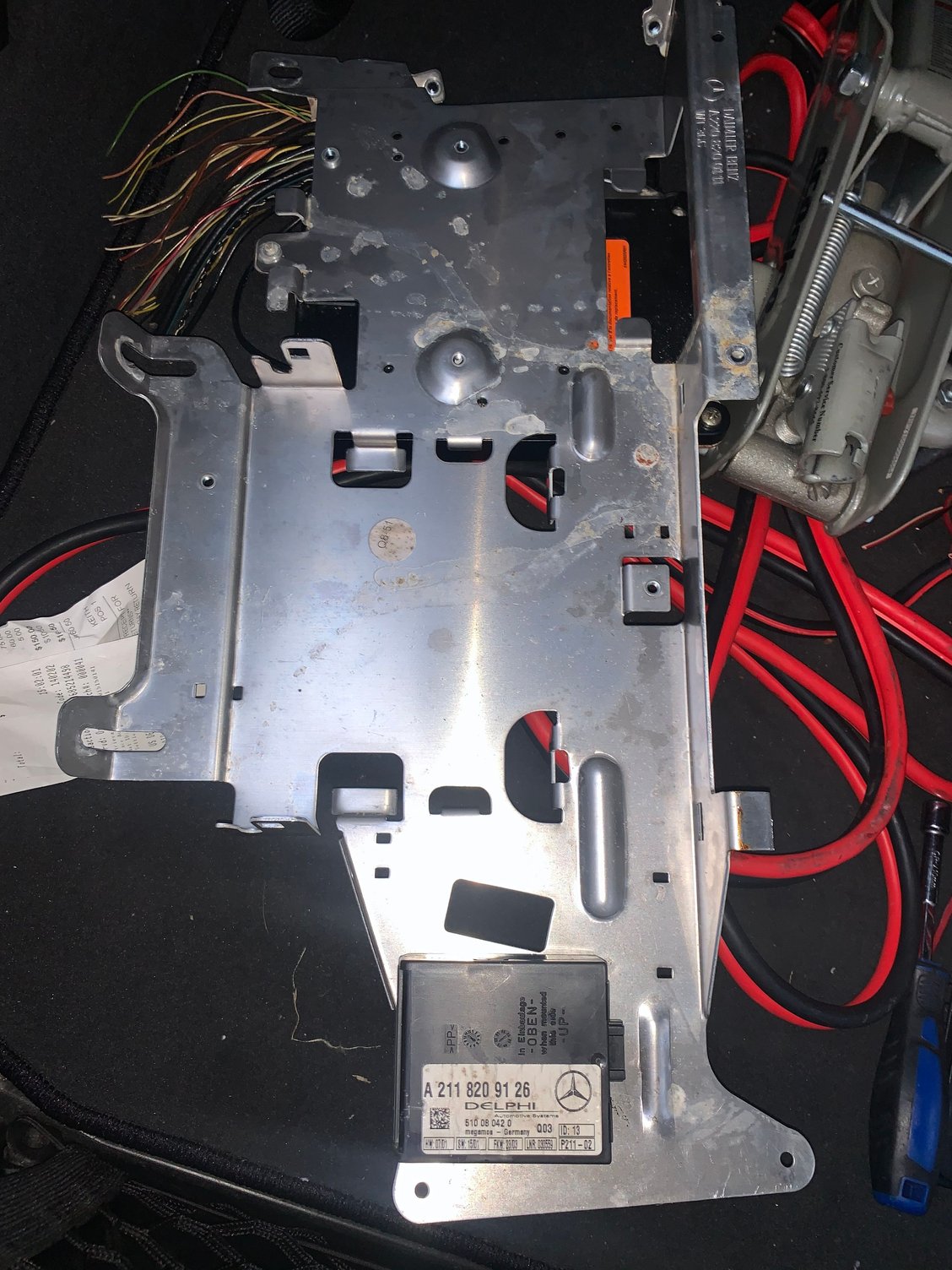

Old Sep 28, 2020 | 09:08 AM
  #44
Jpleas's Avatar
Joined: Sep 2017
Posts: 41
From: Birmingham, AL
2003 s500 (W220) Base
UPDATE!!!
I cannot thank you all enough! I went to the junkyard and got what I think I need. The 2 cars they had were pretty much gutted, BUT the backseat in both were intact.
I removed both SAM's and even the plate that holds them. I will need to check with you all about the rewiring of the SAM, I do not want to mess anything up.
Now it seems like there is a humming coming from the rear of the car when it is on. Sounds like it could be the pump, but I am not 100% sure. I hope installing this SAM resets things and get things back to normal.
