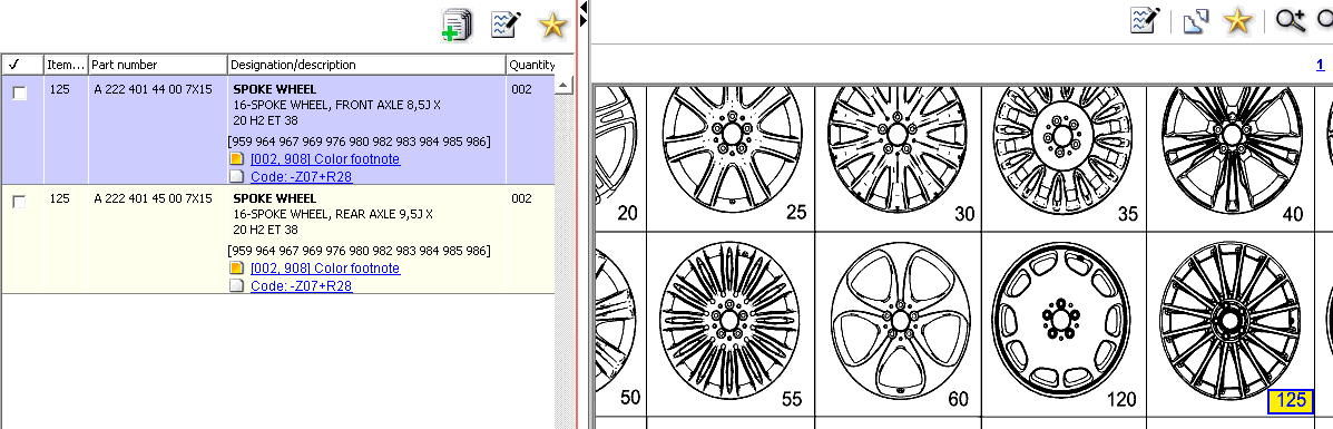

your picture looks better than reality
picture here better

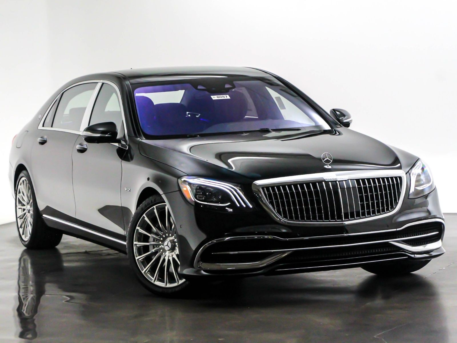

they are still delivered on latest Maybach s 650 ect
there are a few on ebay
count minimum 3000-4000$
