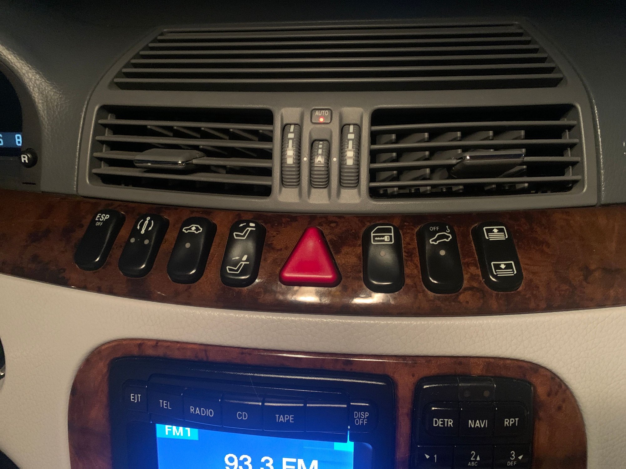

Hi all I’ve got a 2002 s500 and my center dash board controls do not work the hazards don’t work the buttons don’t work none of em work I’ve tried searching for the fuse but cannot find it. Where do you think the fuse would be? Could it be a wiring issue?

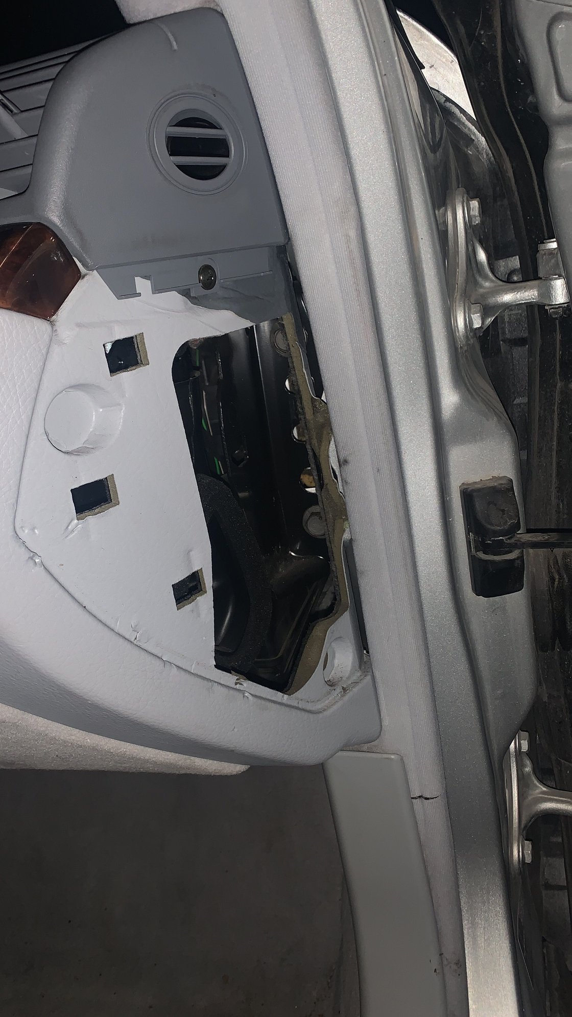

I’ve searched for the fuse and can’t seem to find it when I pulled the panel on the passenger side where the interior fuse box is supposed to be but there’s no fuse box in there

I’ve searched for the fuse but I can’t find one I’ve pulled the panel where the fuses are supposed to be in the passenger side to find the fuse only to find there is no fuse box at all in there

The dash panel first appeared with the "facelift" W220 in 2003. You need to look for the 2000 - 2002 fuse chart.
