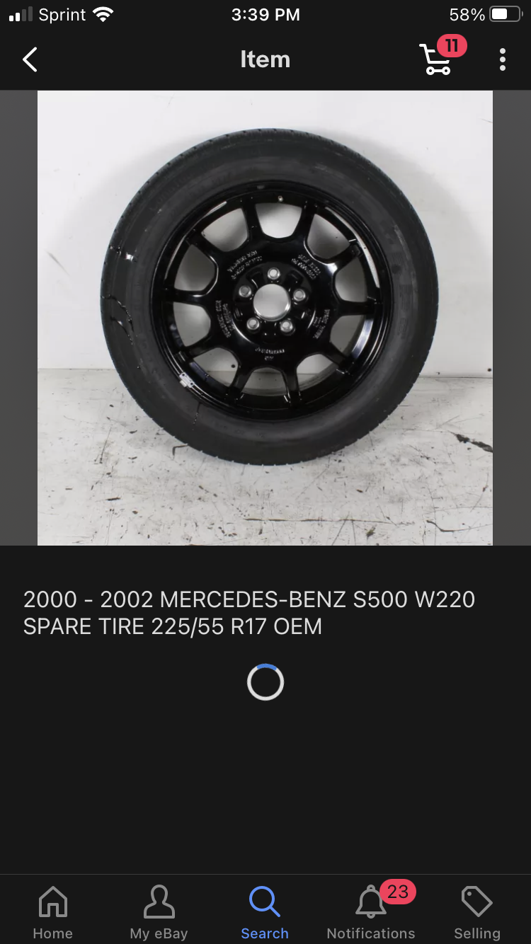

Can I run 4 spares as regular wheels?
Call me crazy but I kinda like the way the spare wheel looks.
Hypothetically, if I was to get 3 more and run a full set of these spare wheels, could I run theme everyday?
I know some spare wheels are only meant to be run for 50 miles or at low speeds.
Does any one know?
Cheers

I agree both the black 5 spoke 16 inch and 10 spoke 17 inch spare looks good. The 18 inch spare looks even better !!
Remember that
it’s the tire , not the wheel,
that is rated for low speed
if you get 4 spare wheels and put regular tires in them then you can use them normally

Mercedes says, "NO!".
The owners manuals specifically state that the spare wheels are for temporary use only.

Yes but we have to examine why Mercedes says no.
Most companies limit speed in spare wheels as they are thin donuts . But The w220 spare is full size .
so Is it because the wheels aren’t strong enough ? No way , the wheels must meet tuv requirements
it also seems many of the tires are full size normal spec tires . If they are special “spare only “ tires inflated to 60 psi then yes you need to maintain low speed . At least the 18 inch spare tire is a zr rated Michelin , so it can handle the speed
then comes the issue of mismatch . For example the 18 inch spare is a 245/45/18. That matches the front of cars with amg package but is a mismatch for the rear staggered size . And it appears the spares are steel wheels versus the aluminum main wheels. Therein likely lies the mismatch in weight and sizing causing the low speed recommendation .
but if all 4 of your wheels are matching steel spares with matching weight and tire size and proper speed rated tires , there should not be an issue
