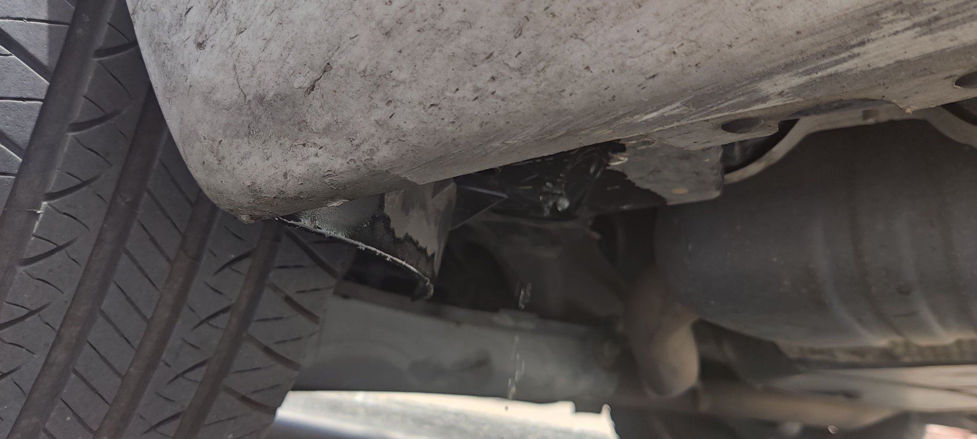

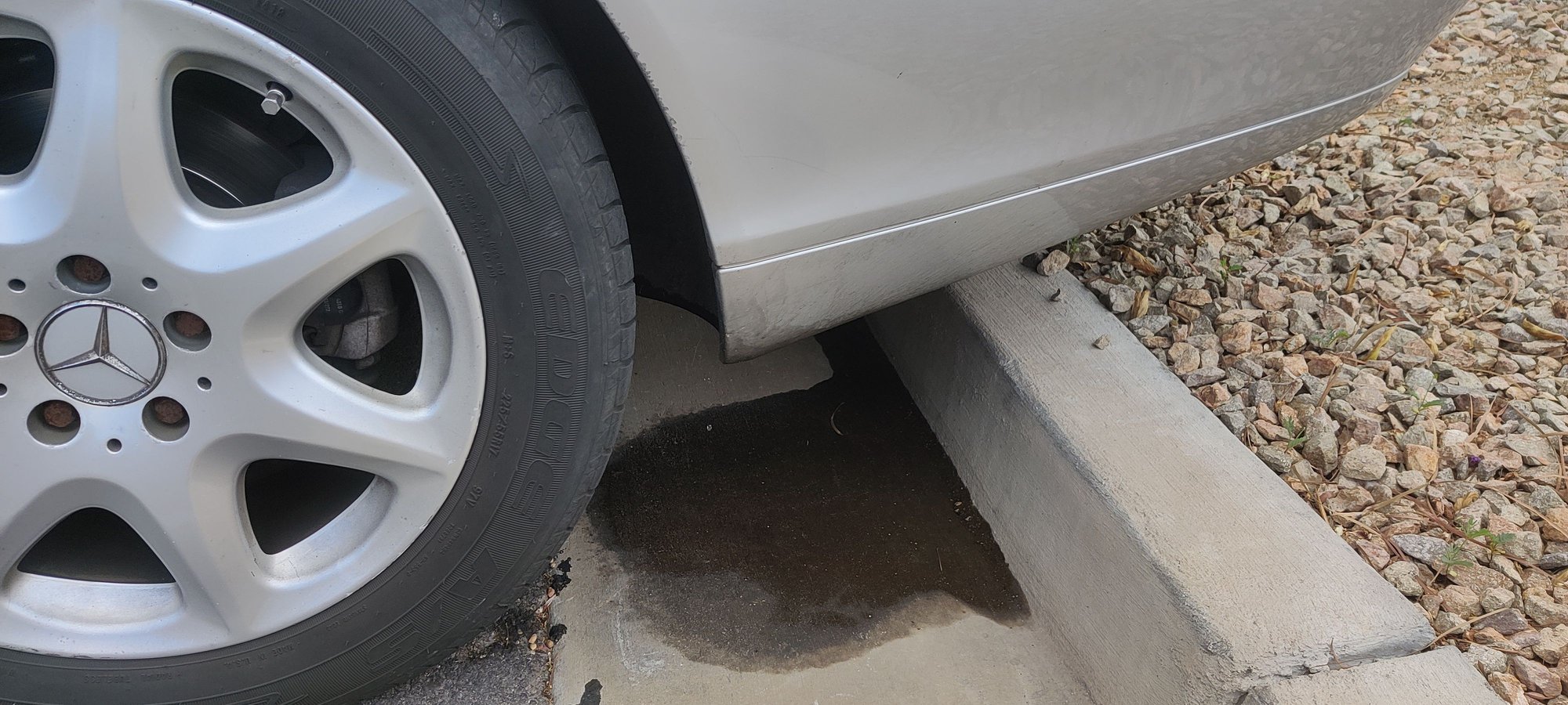

I get back in the car, start it up, drive....power was fine again, but then it started sputtering at stop lights, then noticed loss of power again, and this time found gas POURING out the back of the car (see pics)
thoughts? im gonna take covers off tomorrow or friday, but wow, this was pretty random, is it possible the fuel filter internally failed???

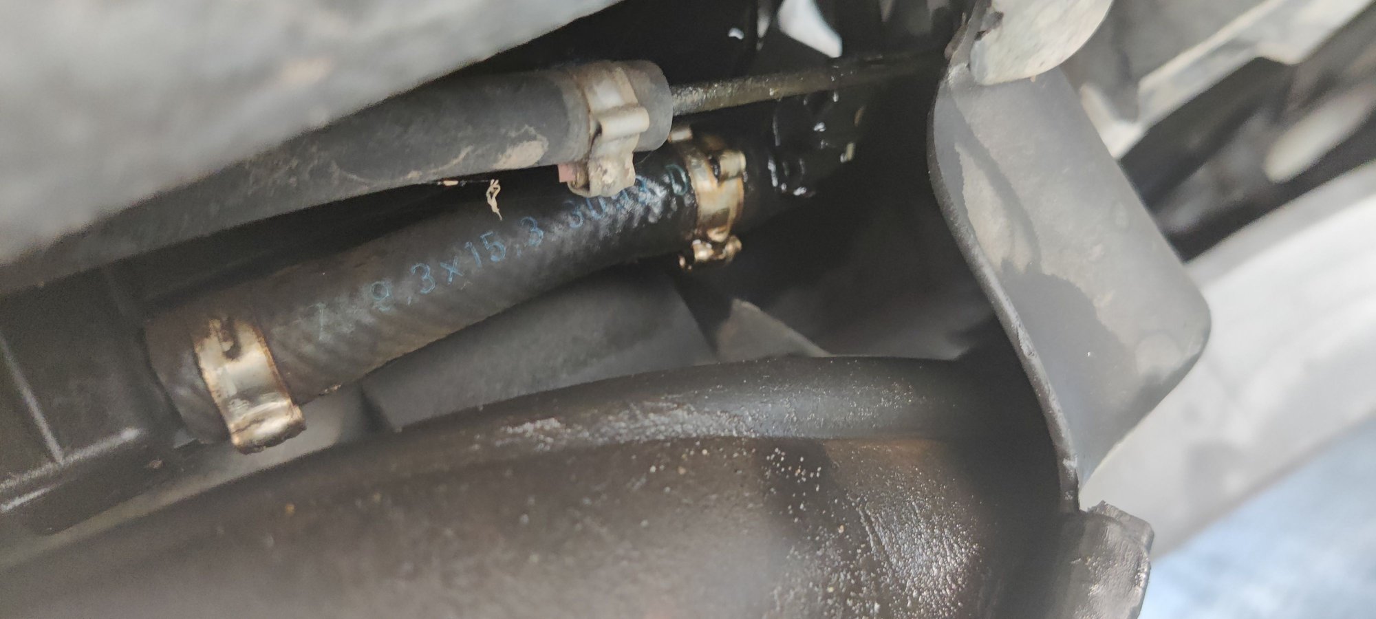

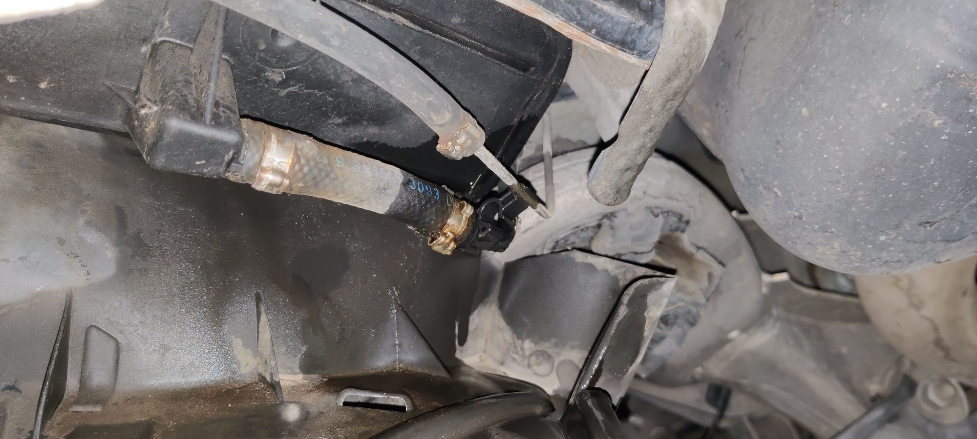

found the leak, i dont think gas shold be pouring out of this so ill have to assume this is shot.
i want to add this, i had ZERO gas smell or leaks or loss of power with the old fuel filter.
