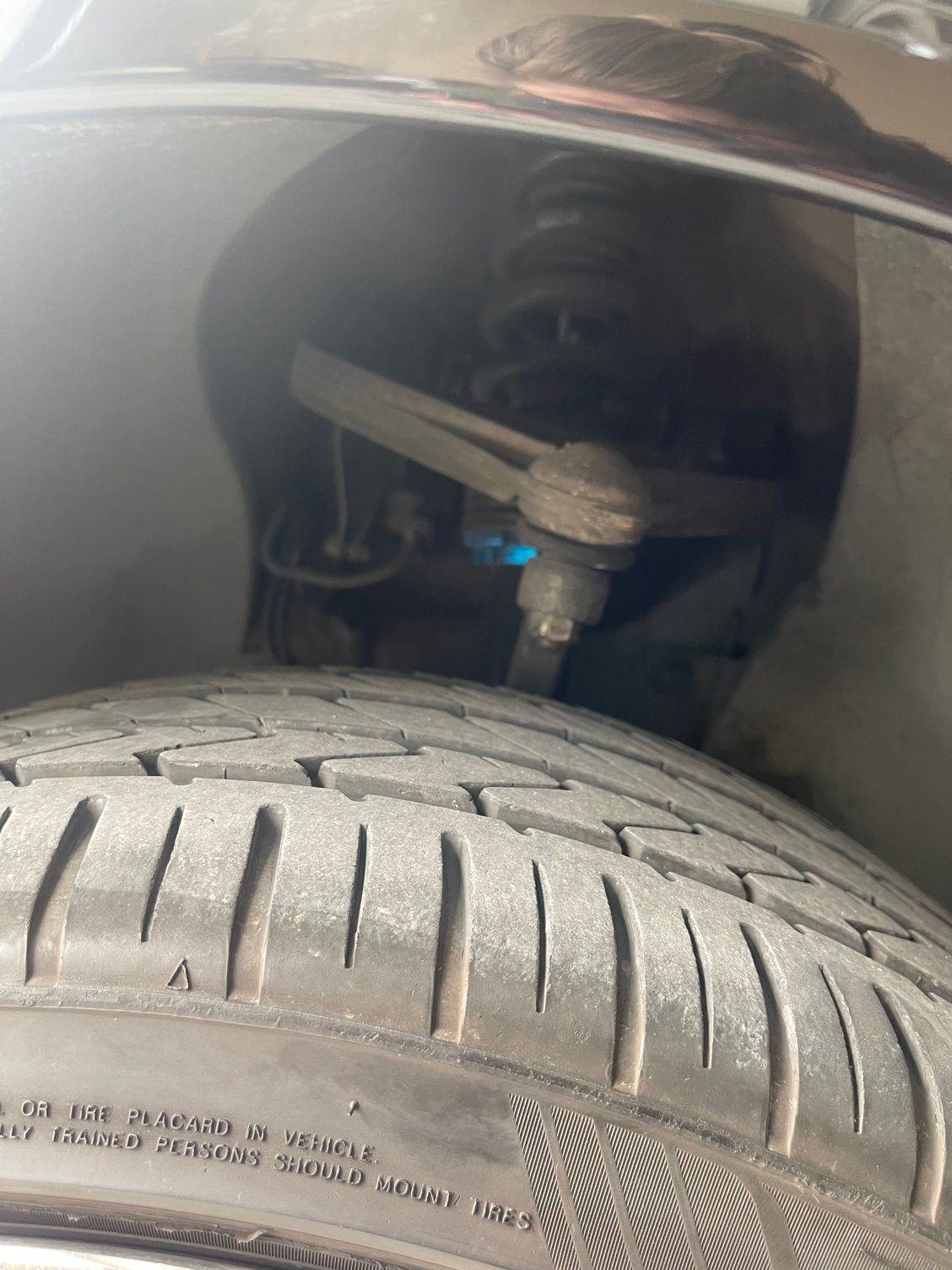

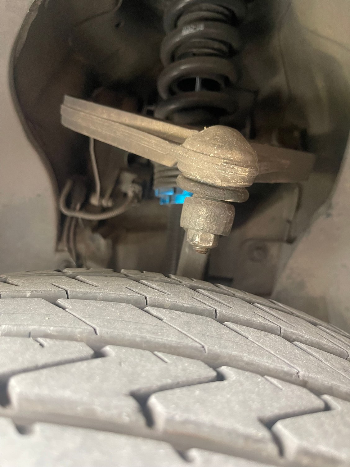

I completely overshot my tire sizing. I bought 255/35r22 for the front. I have an adjustable suspension, but I didn’t account for the suspension components to be in the way.
The setup I have now in the front is 245/35r20 and I have less than an inch of clearance between the bolt and the top of the tire.
Now when it comes to spacers, I have no idea how to measure for how much clearance I might need. I know it will more than likely stick the tire out from under the fender a bit, but I am not sure what mm of spacer to get.
Current Setup 245/35r20

It is easy to calculate wheel spacers:
In your case, you need to clear that bolt and if that is going to push your wheel out of the fender and if you have enough clearance under the fender esp when the car is lowered... Usually hubcentric spacers are recommended and mine came from Bonoss with the extended bolts, since the original bolts will not be long enough to hold it... Also a good way to check your spacers are good:

so the spacers will help me clear the bolt, but the tire size I keep seeing others use is 245/30r22. I am afraid an /30 will not work and I’ll have to use a /25.

Yes, you need to clear that bolt. Increasing the sidewall might be an issue even on the fender with the wheel spacers.
