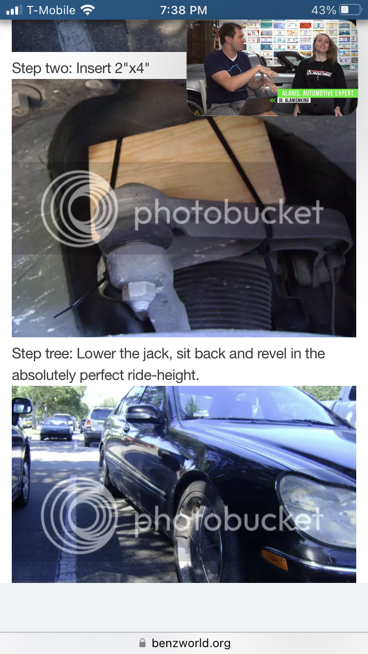

Old May 15, 2023 | 02:18 PM
tusabes's Avatar
Joined: Jan 2008
Posts: 6,151
Likes: 533
Mercedes
Wood 🪵
Wood
block
