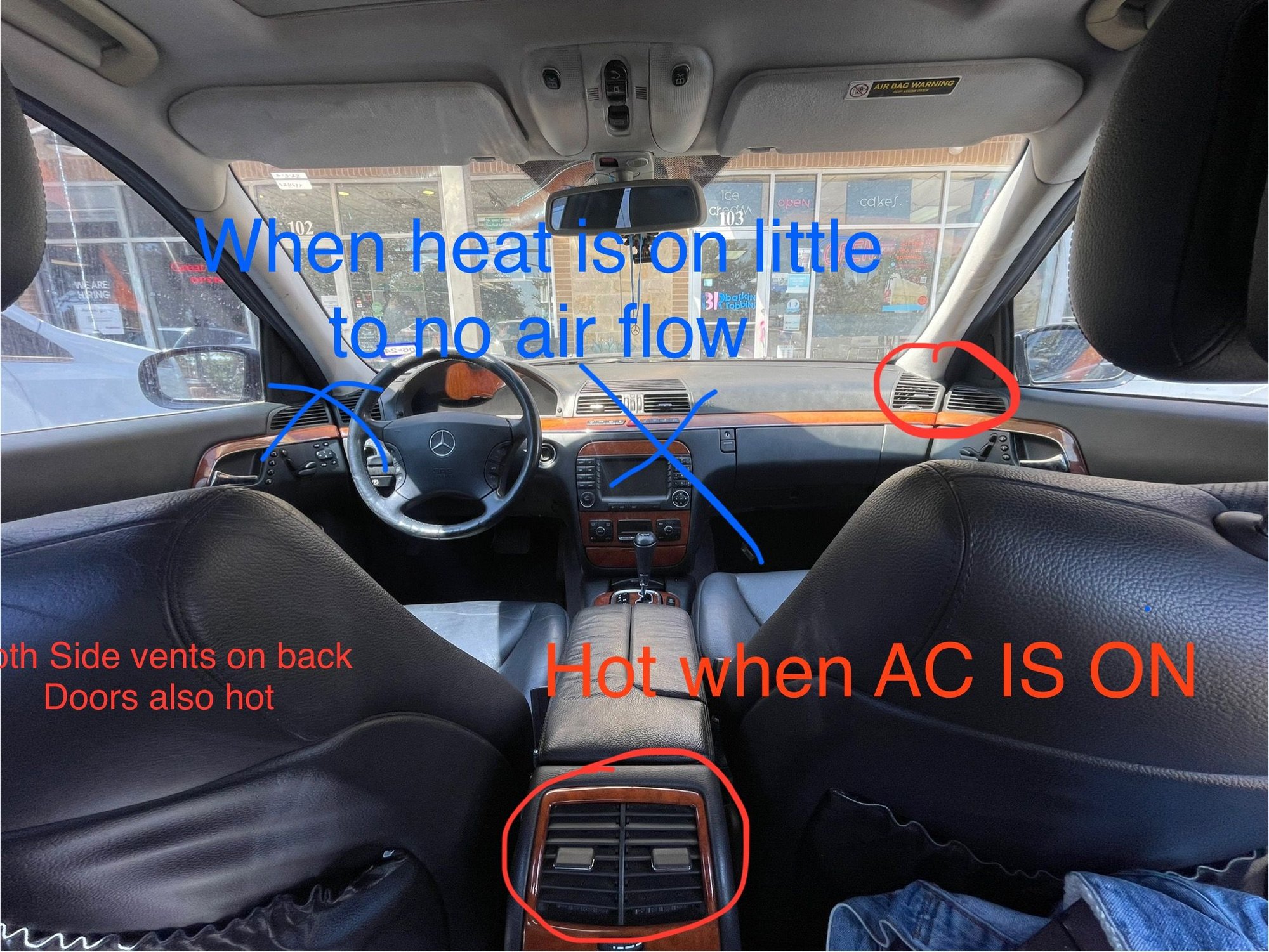

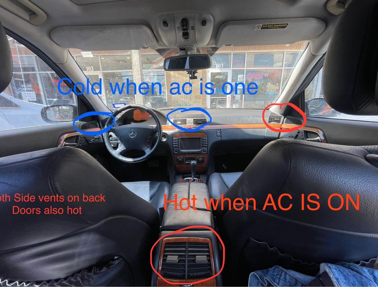

Having problems with my AC new to MB
The best Diagram I could come up with. Hopefully this gives a better understanding.
I'm tossed up between
A/C Heater Flap Blend Door Actuator. The control module or the dual heater valve? I get no trouble codes when I go into the AC menu using the rest and filter button. I'm gonna have to spend the money either way I understand that but I'm just looking for a way to diagnose the issue without spending $275 for someone to look at it if anybody has any advice or any further information I could use that would be appreciated, because so far by looking through the form I've seen a lot of different issues that can cause a similar problem

The HVAC ia a complicated computer-controlled system. Starting here https://w220.wiki/#WIS_83_Climate_Control and doing a lot of reading will help a great deal.
My first guess is the duovalve. It is well within reasonable DIY to access, disassemble, clean and reinstall. There are pretty detailed how-to info posts and videos - search for w220 duovalve and w220 duo valve.
https://www.benzworld.org/threads/od...#post-16184778
If you push the left round button, you can manually control where the air comes out, and each vent has a manual flow control (the wheel). There are several unexpected control and options - the Owners Manual covers them pretty well. If you don't have the Owners Manual, they are available on-line.

GeT a used duovalve off eBay
