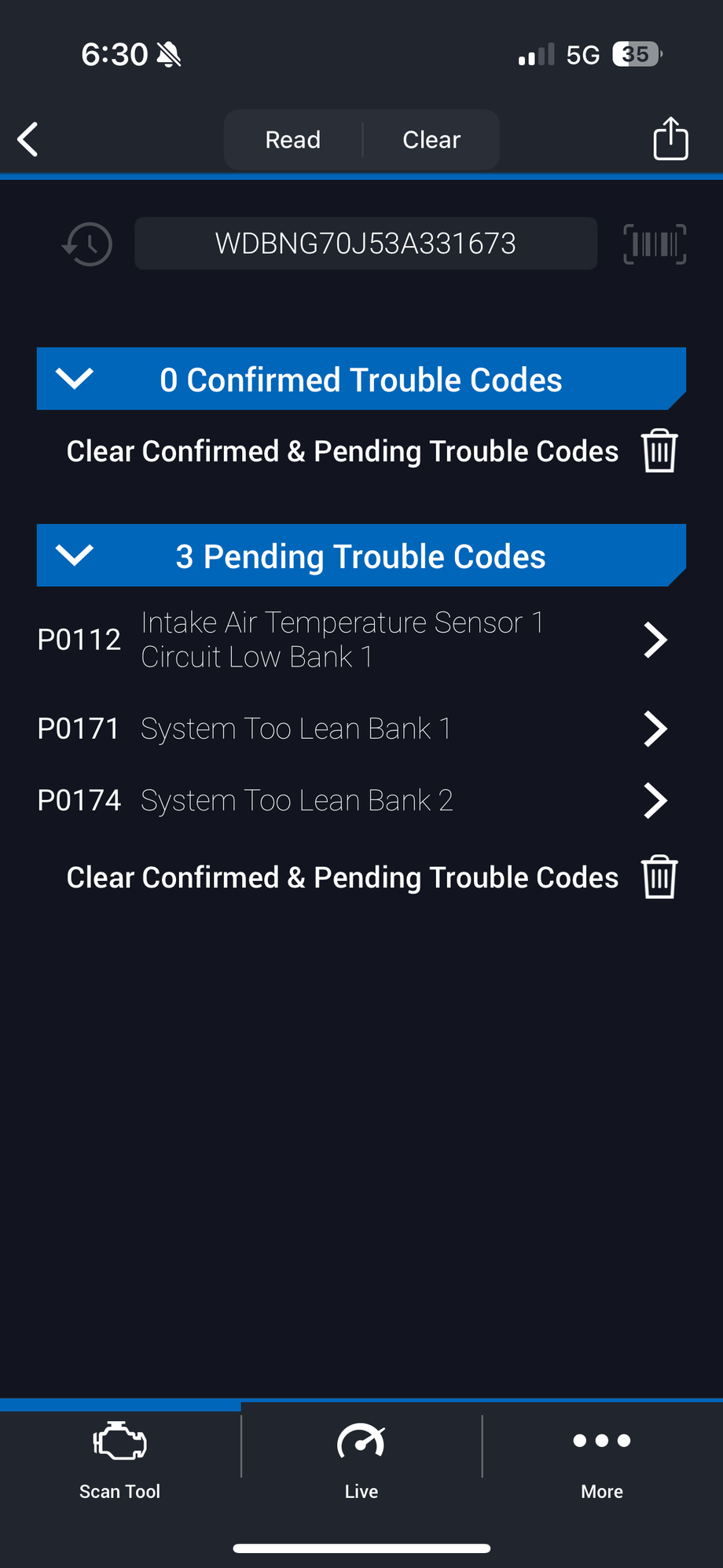

- Check engine light pops up 1 hour into drive, immediately pulled over and ran a scan with my cheap bluetooth obd2 scanner
PENDING TROUBLE CODES
- P0112 - Intake Air Temperature Sensor 1 Circuit Low Bank 1
- P0171 - System Too Lean Bank 1
- P0174 - System Too Lean Bank 2

get a new air intake sensor before you waste money on 16 plugs and 8 coils . Yes they use 2 plugs per cylinder
