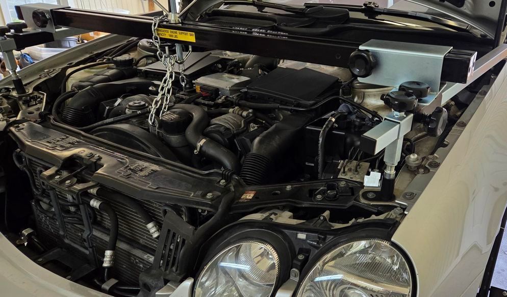

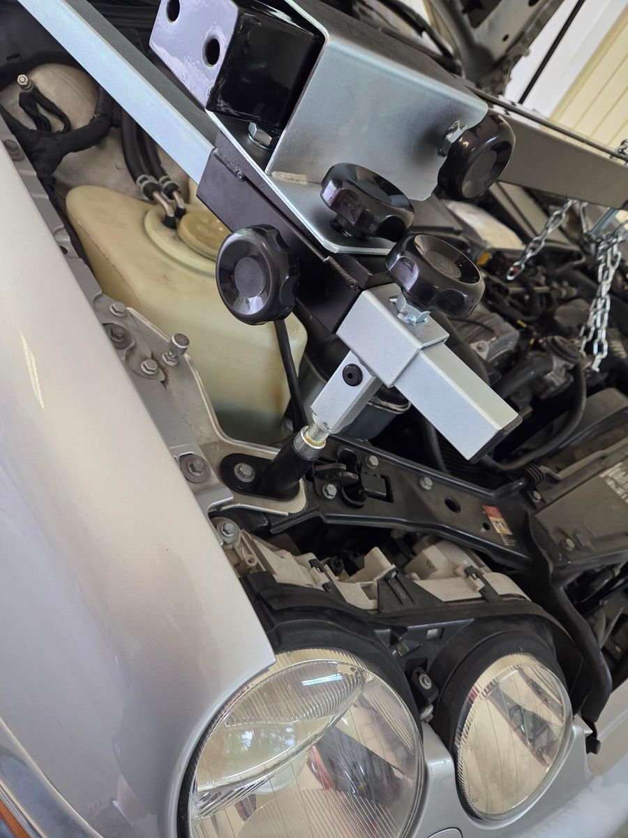

Want to do some work under the car, need to get the upper oil pan out.
So got the support bar for the engine, but looks a bit suspect to me. The bar itself is very beefy, so I have no doubt it would work.
The location where the chain attaches to the engine looks a bit suspect. Not sure about attaching it to the oil filter housing?
Also looks like it might break that plastic piece.
Anyone done this before?
I will also put a jack under the transmission bell housing for extra safety. The M275 is almost 600 lbs, so better safe than sorry.

Better safe than sorry is exactly right.
Never rely exclusively on a jack. I agree it looks/feels not right, and that it'll break something. I used the engine support bar only as an emergency backup in case my primary engine support, a jack on the oil pan, somehow failed.
