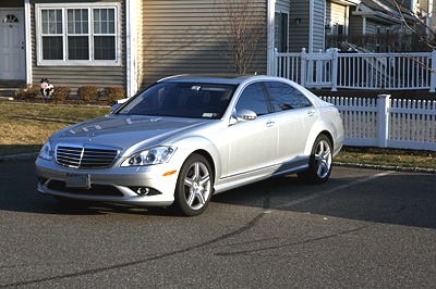

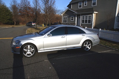

few photos....before the crack
just few photos after car wash
Attached Thumbnails Front windshield replacement?-img_2392_1-9365-.jpg   Front windshield replacement?-img_2412_2-2482-.jpg
