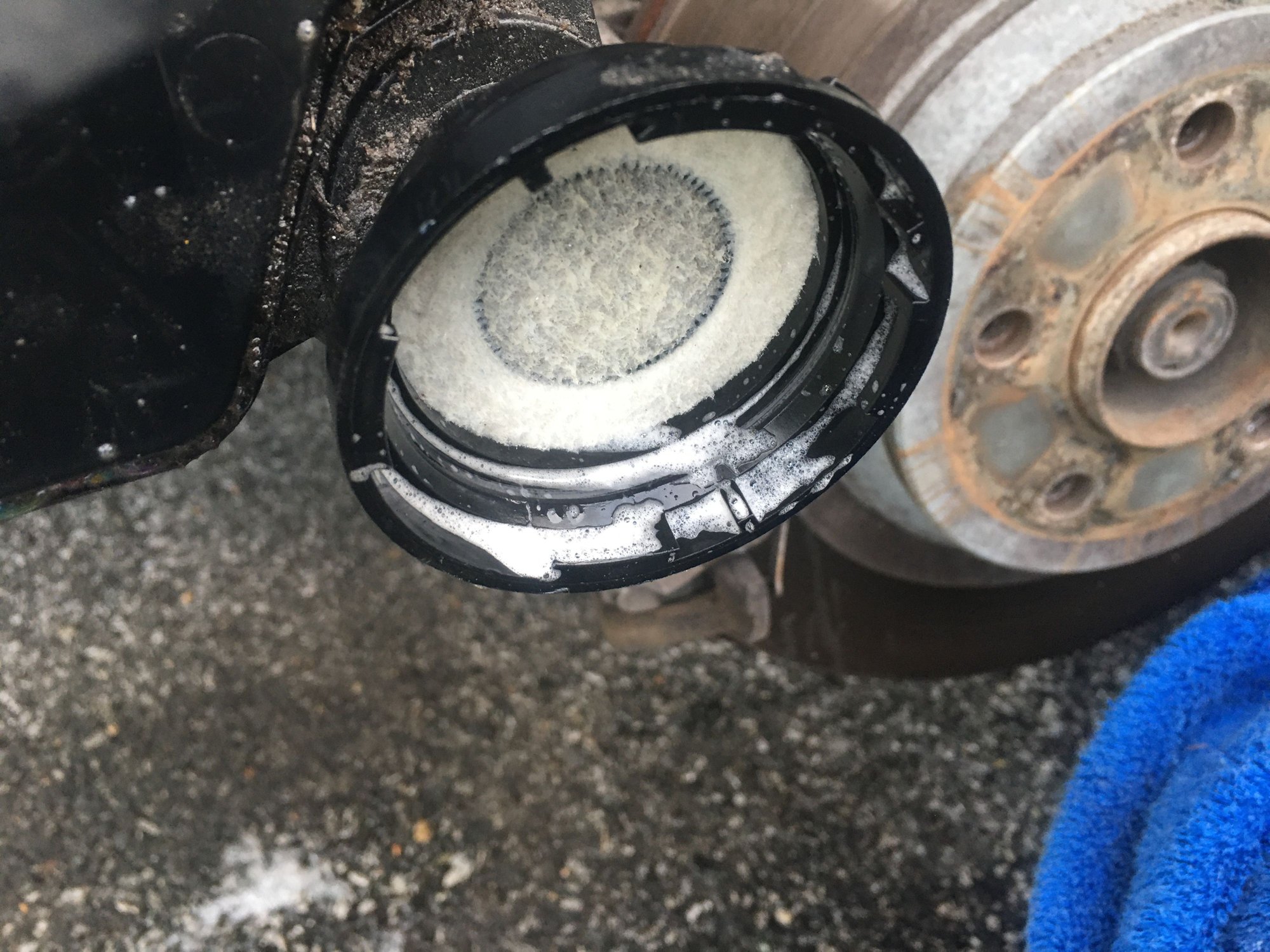

Just filled up after cleaning the canister filter under the solenoid with plain soap and water—this actually works!!
This thread references the 550 but on my 600 the process seems to be surprisingly less complicated.
On the 600 you’re removing 3(10mm) screws to release canister from the body of the car and it’s completely unnecessary to unclamp the bottom hose.
Those factory clamps are a headache and can easily make this job more time consuming than it needs to be.
Once you remove the 3 screws, the main breather hose on top the canister is a simple squeeze tab and pull up.
When the top hose is removed the electrical connector to the solenoid is a simple squeeze clip and once disconnected the canister can be moved freely pretty much
(STILL TAKE YOUR TIME AND MOVE CAREFULLY)
I turned the canister completely upside down to clean with no issue—
**BE SURE TO PUT THE O-Ring back after cleaning because you will get a P0455 code🤣🤣🤣 ask me how I know this*

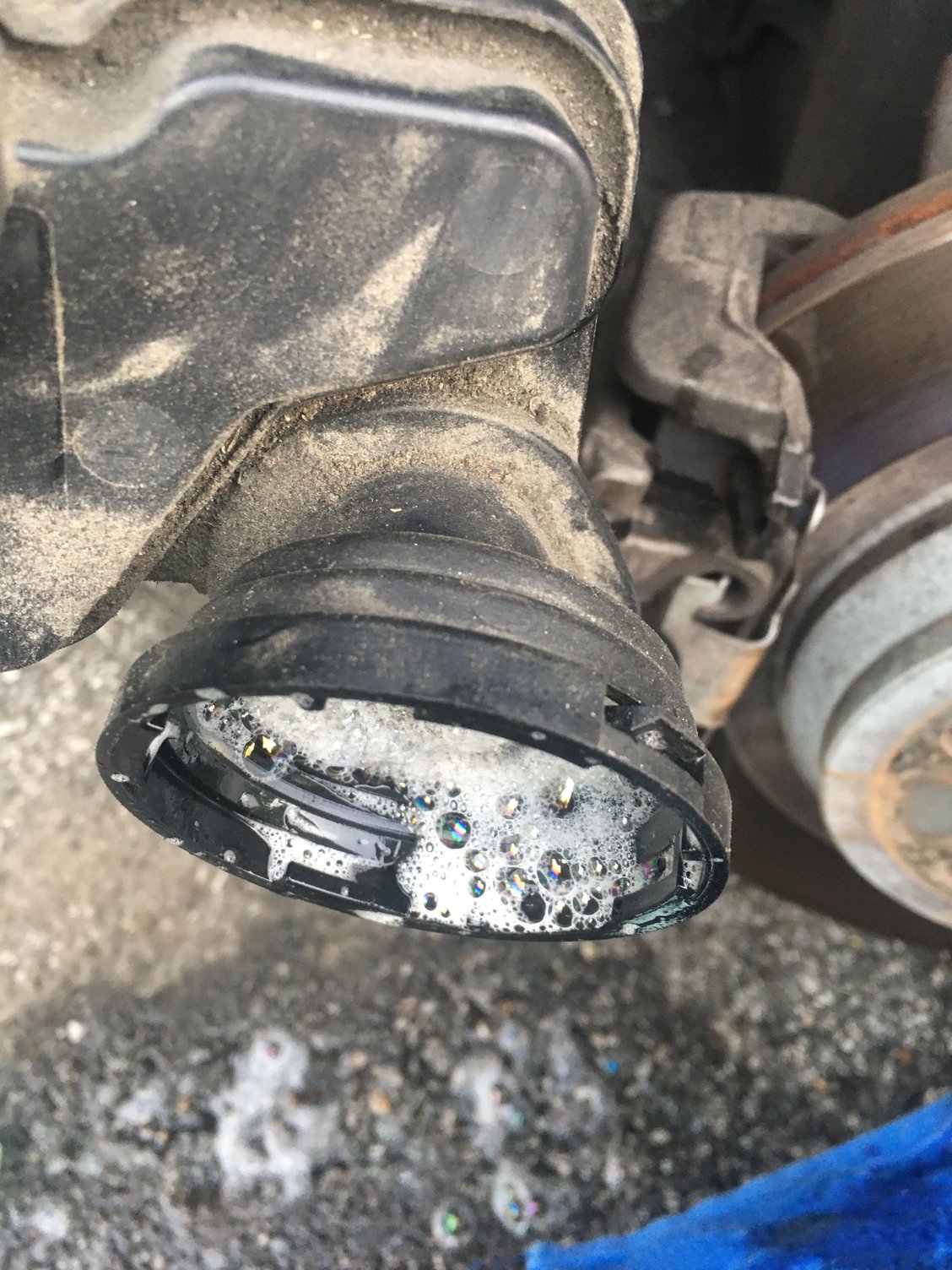

This is after shaking out a lot of dirt and first wiping down was much dirtier then I decided to take pics so this is not even as dirty as it was upon first opening.
Cleaned with dish soap and water. Kept the opening downward and sprayed soapy water upward to ensure water was never able to settle in the filter housing. Used an old dish soap bottle to squeeze soapy water upwards and had a separate clean fresh water bottle to remove soapy water while gently scrubbing with a clean rag.
Filter started off completely soiled and dirty this is after.

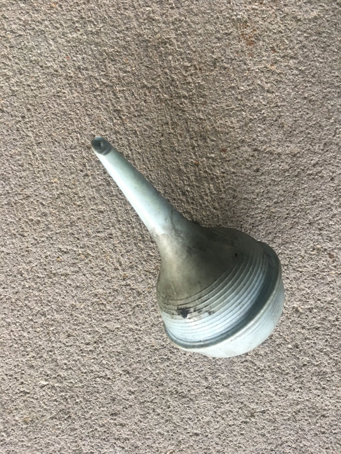

I would have loved to have some pressurized air but no access—so I simply found an old baby nose suction and cut the tip diagonally to create a angled surface to improve suction which was more than enough to PULL THE DIRT OUT—intuitively this seemed like a good idea lol
Used to suction moisture out of filter primarily and once visibly dry I also used it to blow air over filter. I also turned canister upside down and suctioned the main hose opening just in case there was any debris that was there after gravity did most of the work.
