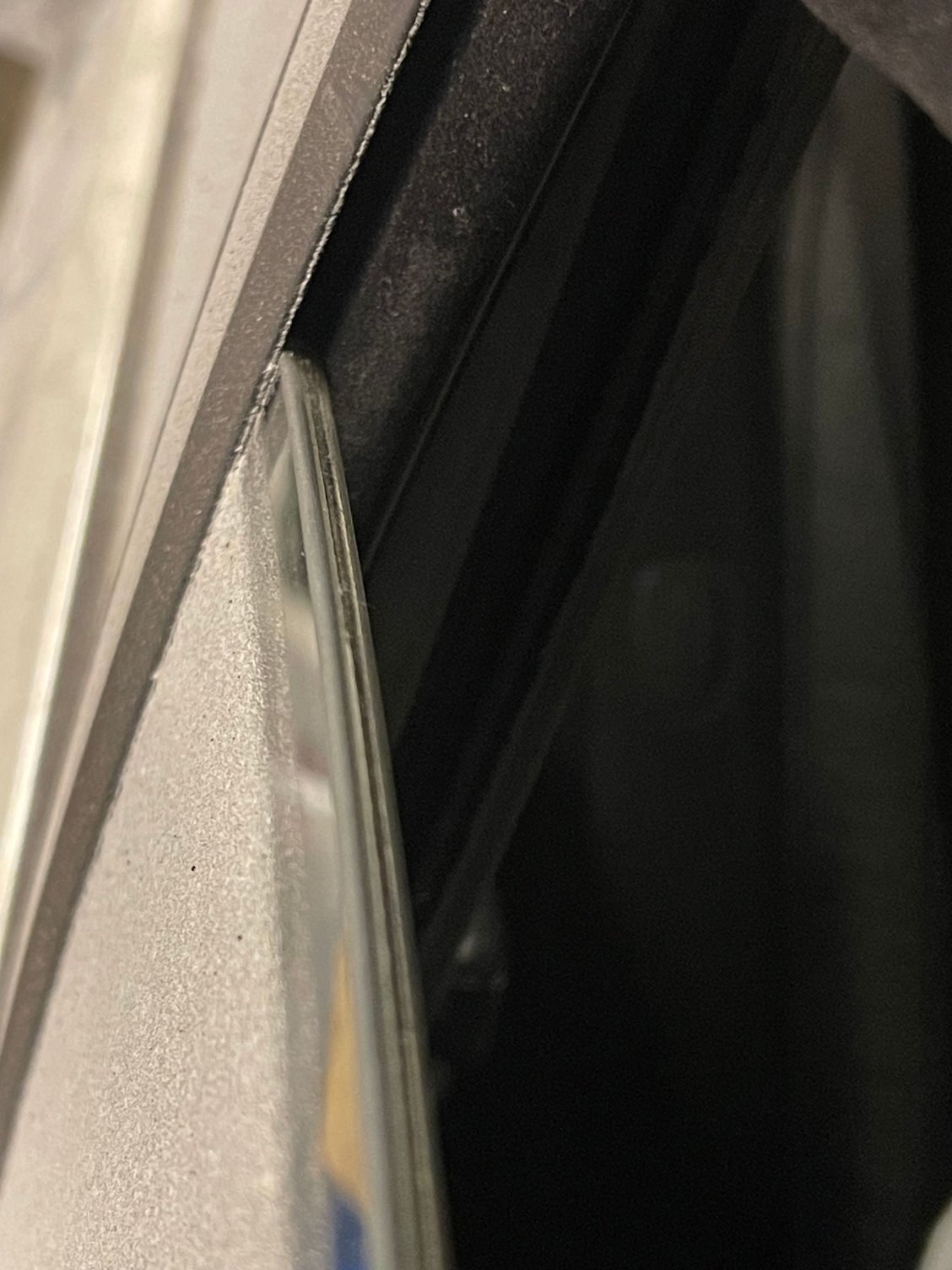

Managed to get a full set, for those wondering. The difference in thickness is very small. Measured using s micrometer about 1cm from the top edge of the rear windows around the middle.
Sungate (double glazing): 5.44mm
Solargreen: 5.31mm
A 13mm difference is all, or about 2.5%, hence why the same seals can be used.
The sungate one is more reflective in the sun, appears as if it was tinted (surprise). Appears cooler (as in more blueish than green).
The solargreen is green alright.
The sungate edge appears as such:

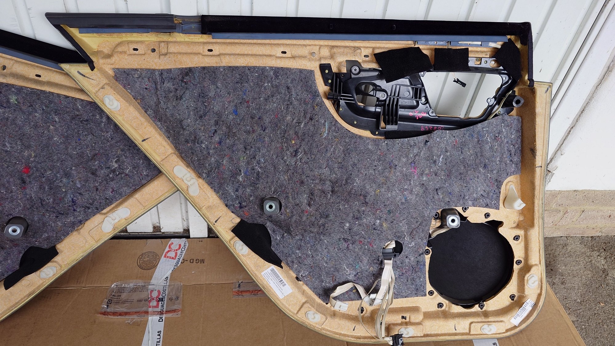

The reason heat insulated cars seem quieter is due to the insulation layers attached to the door cards.
This isn't fitted to cars without the heat reflected glass.

Spot on, got a complete set of that as well, with double pads for the front doors (incl a new pair from MB USA)
