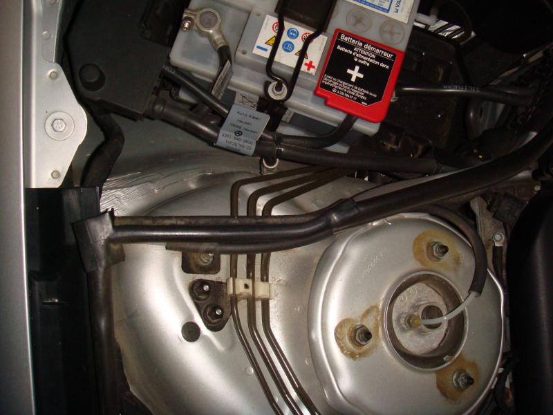

I own a s550 07 (w221) preowned and during the first year i noticed vibrations coming through the steering wheel and seats. Took it to the dealer and they couldnt figure it out, after that my suspension kept malfunctioning, also my air con has this horrific smell every time i turn it on. After that my tranny jerks when shifting from 1st into 2nd which mercedes said all s550's do that when they are warming up, i know that they rev higher to warm up the engine quicker on cold starts but they shouldnt jerk. Lastly, I needed to know if anyone out there owning a 07 s550 or higher can see weld marks located behind the front suspension wells on both sides when looking from under the hood...i have attached a picture of those welds and if someone could let me know if they have them or not. This way I can determine if this car has been in a collision of some sort which would explain these problems....please i need your guys help....

I was hoping to check my car and see the same thing for your sake, but mine is much much neater than that. On my car it looks like a 1" wide 1/8" thick rubber/asphalt tape (body colored) that covers the seam. It is very neat and looks like it should be there. Your seam looks like it was applied from a caulk gun and smeared down into place. I don't think yours is stock, I think it was done by a body shop.

Mine has that asphault looking tape as well, but AMG POWER yours really don't look that far off. IMO I think you are ok on that being factory. Why is the 3 nuts for the struts look rusted in the surrounding area though?

His does not look bad, it looks like the way other manufactures do it. It does not look like the particular method MB uses (not to say it is better or worse, it just does not look original). I was also wondering on the bolts....

jta001r and emilner, those bolts seem to have a sticky substance on them, they don't actually have rust I believe. I think the reason is that its a Canadian car and so Im pretty sure they coat it with that to prevent rust, my other car has the same on it. I guess it has to do with the snow and all, do you guys think I will get any compensation if they did sell me a car that has been in an accident and they did not notify me about it?

honestly, that doesn't look unusual to me. Its just some seam sealer.
the cleanliness of the application looks about right. Some cars look neater than others.
