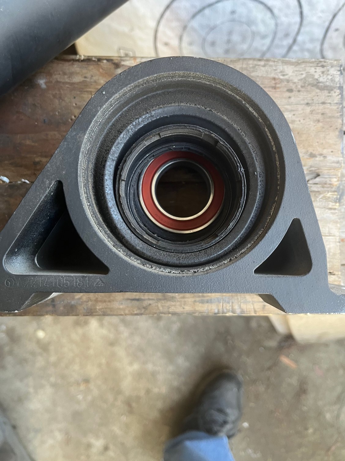

Im still battling a very mild vibration at 45 mph, in steering wheel, then at 70 under my seat which feels like a grind.
NEw engine mounts, trans mount, all new tires, rotors and such. Wheels checked and rechecked.
80-90-100 mph smooth as glass. So thats not a bent wheel, centrics or anything in between.
Could be the druve shaft bushing. But I give up at this point.
Propeller shaft center support bearing/holder.
I suspect it. Is it possible to check it on our car without taking off the exhaust ? Is it easy to check before I order the part. Because at that point might as well change the rubber donuts as well on both ends right ?
shop I s my MB guys that are doing it. They know these cars well. Won’t be cheap.

S500
there is a load of rubbish in the way - exhaust off, heat shielding off - all the parts from Mercedes >$800 - there are two weird bearings they claim are bushes pressed in to the ends of the propshaft to keep it square to the gearbox and diff - they should be replaced alongside the centre bearing and housing
40 year served Merc only parts guy said to me - "you know no one ever buys them, - but its these bushes that cause the vibration" - he also swore blind aftermarket idiots saying front and rear donuts and bolts are the same is BS - and thanks to Senecat I discovered they were both 100% correct
if early in the saggy centre mount ageing - I suspect you could just get the middle of the propshaft to sit 10mm higher replacing just the centre mount so it sits where its meant to be - and save the agro of swapping donuts and those bushes
Thanks. So just to check it exhaust must come off? I want to make sure that’s the part that needs to be changed, if so I’ll get the center support bracket and bearing which is $200 from FCP for mb parts. I expect labor to be close to $500 if not more.
all for a mild vibration at 45 and at 70, which by the way I can modulate by letting off gas pedal on and off.
That confirms it's a driveline issue.
Have you change the diff fluid?
we can't diagnose remotely - that’s impossible - but saggy centre bearing is std - all mercs do it - its just taken us far to long to realise
from the CATs back the exhausts have to come of - due to an incompetent design - mine exhibits (as most say) a feeling like wheel imbalance around 60mph - it goes away after a 20 mile drive when all the rubber bits warn up - likely thinking now, the donuts get flexible enough to allow the prop to wobble till it less unhappy than having to throw the entire car up and down
You need to take only the rear part of the exhaust off and then the heat shields. Easy job.
If you desire to change donuts too it adds little to the job but should not be bad. Parts cost, of course and time whoever does the job.
I did not replace my donuts for my 2013 model as I had them done by MB garage chasing this vibration issue. They told me it is normal that the center bearing moves. Donut change did not help and I then replaced the bearing that fixed the vibration problem.
Rubber bearing “housing” had sagged about 1/4” or so. Bearing itself was fine, but sure replaced it too.
I face the same job again now as my 2013 was totaled and I have a 2012 model now with all same options (and problems) so I’m planning for it in a near future.
So, yesterday tackled the propeller shaft center bearing job. This made a huge improvement in vibrations from the shaft that now are gone.
Old bearing housing on top of the new one shows how the old rubber had sagged.
