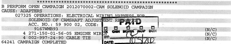

I've attached the portion of my invoice for the camshaft solenoid repair.
Attached Thumbnails Need your help and your experiences In Errors-camshaft-solenoid-recall-invoice-listing.jpg

I didn't know about the issue prior, the dealer just did it while I had the car in for Service B and some other maintenance. I think Shifter's advice is solid and your issue is different, as the dealer didn't have my car for more than 7 hrs.
