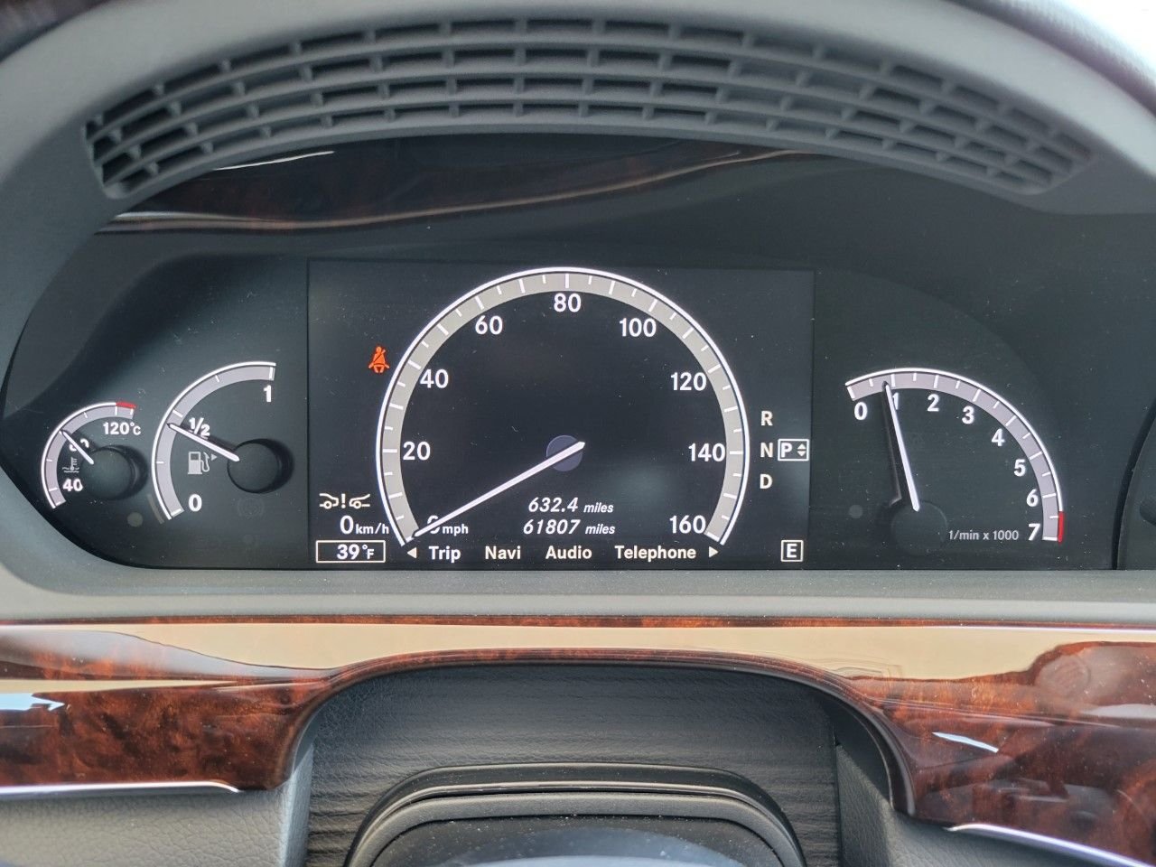

I had mine done a while back when I purchased the car. I always loved the way the car greeted you when you opened/unlocked the door with the AMG Logo on the cluster. I swapped mine with an amg S63 one from the same year ( 2013 ) but work needs to be done via Vediamo and you need to have some knowledge in German in order to have everything working. Below is how it looks like. Before and after. Exuse the smudges, pics were taken right after the swap...

Cluster
just one comment on this - that’s a S65/CL65 cluster as it goes to 7k rpm
The S63/CL63 clusters go to 8k rpm afaik
