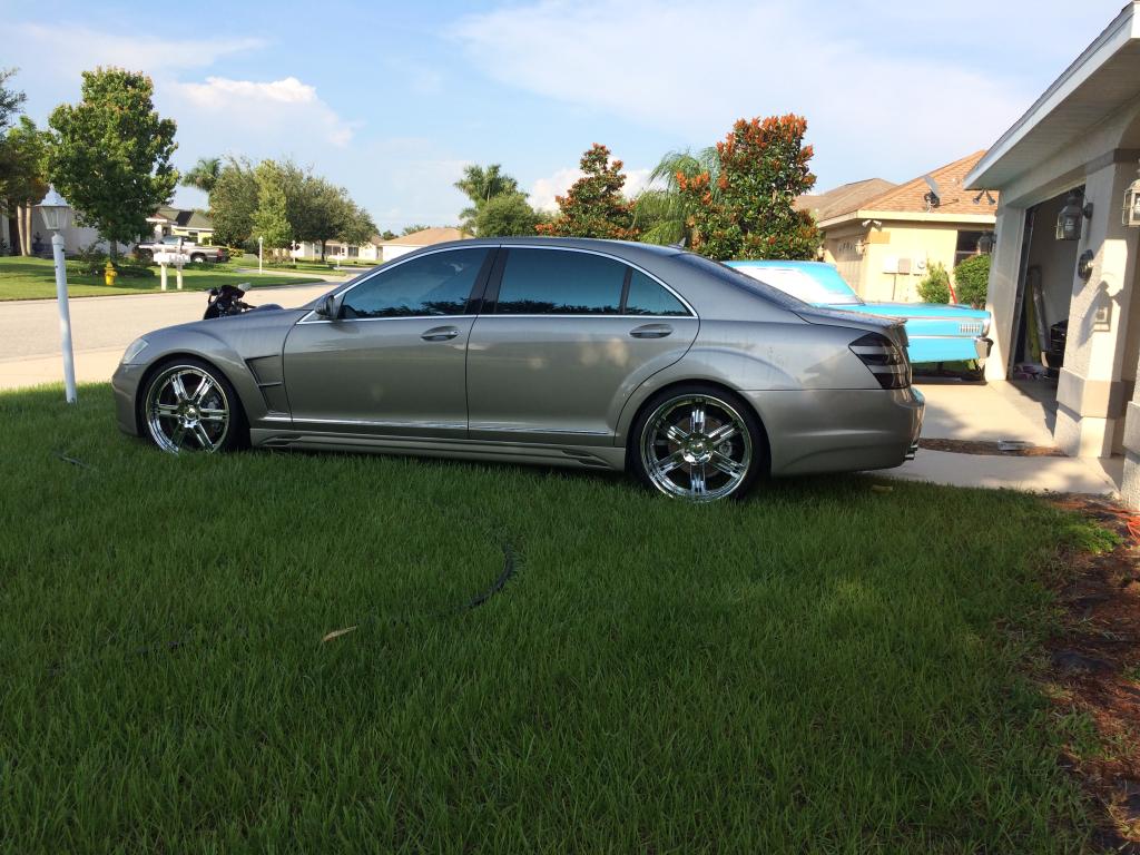

I run 22"s staggered on my 4matic. no complaints here. I keep them inflated at 50psi.
Do you run the same size tires all around? I read that if the tires are not the same it could damage the AWD system.
No, I run 295/25/22 for the rear.
255/30/22 for the front. Like the previous guys said, the diameter has to be the same.
Side note.. Where did you get that body kit? Those front fenders are insane! and yes I am in the market for rims, so I guess it is kinda related to the subject on this thread..

Castro, What did you use for your drop? you have the height that I am looking for
http://www.auto-couture.com/mercedes/w221_pg/index.html
And this is stock height. I guess the 22's give me the perfect wheel gap.
