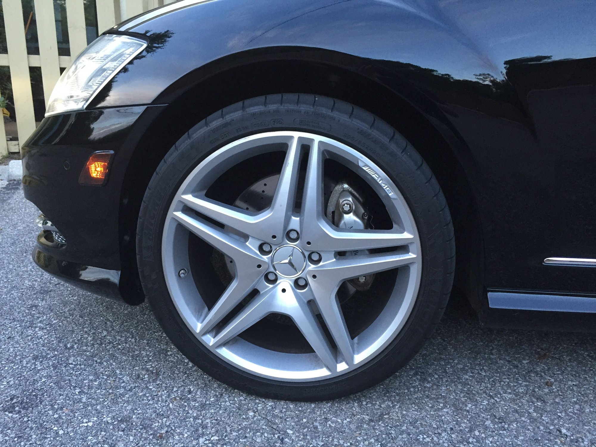

What is widest spacers you have used?
I have 19" AMG OEM
Was contemplating larger wheels but like my style.
Also mine is 4matic if it matters
Thanks!

I probably wouldn't go more than 10 mm. You'll also need to get longer lug bolts.

20mm on my staggered rears and 15mm on the fronts. Rim Diameter doesn't matter. That puts the wheel flush with the fender. As for width I was very skeptical that the car would take them without vibrations but they've been on over a year and ride is unaffected. Ditto on the need for lug bolts with extra length equal to the spacer width.
All you're doing with spacers is reducing offset. It matters what the offset of the wheels are. If they're stock they're 43mm so you'd reduce that by 20mm with a 20mm spacer for an actual offset of 23mm. If your wheels aren't OEM 43mm my numbers won't work.

Thanks Mike, just ordered 15mm and 20mm with bolts
