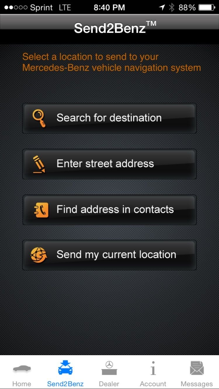

Yep. I have a 2010. There may be some features that only apply to newer cars (Mbrace Plus) but regular Mbrace works fine. Remote lock and GPS location, and Send2Benz
Some screen grabs...
Hit the little microphone icon and speak the address into the app...
