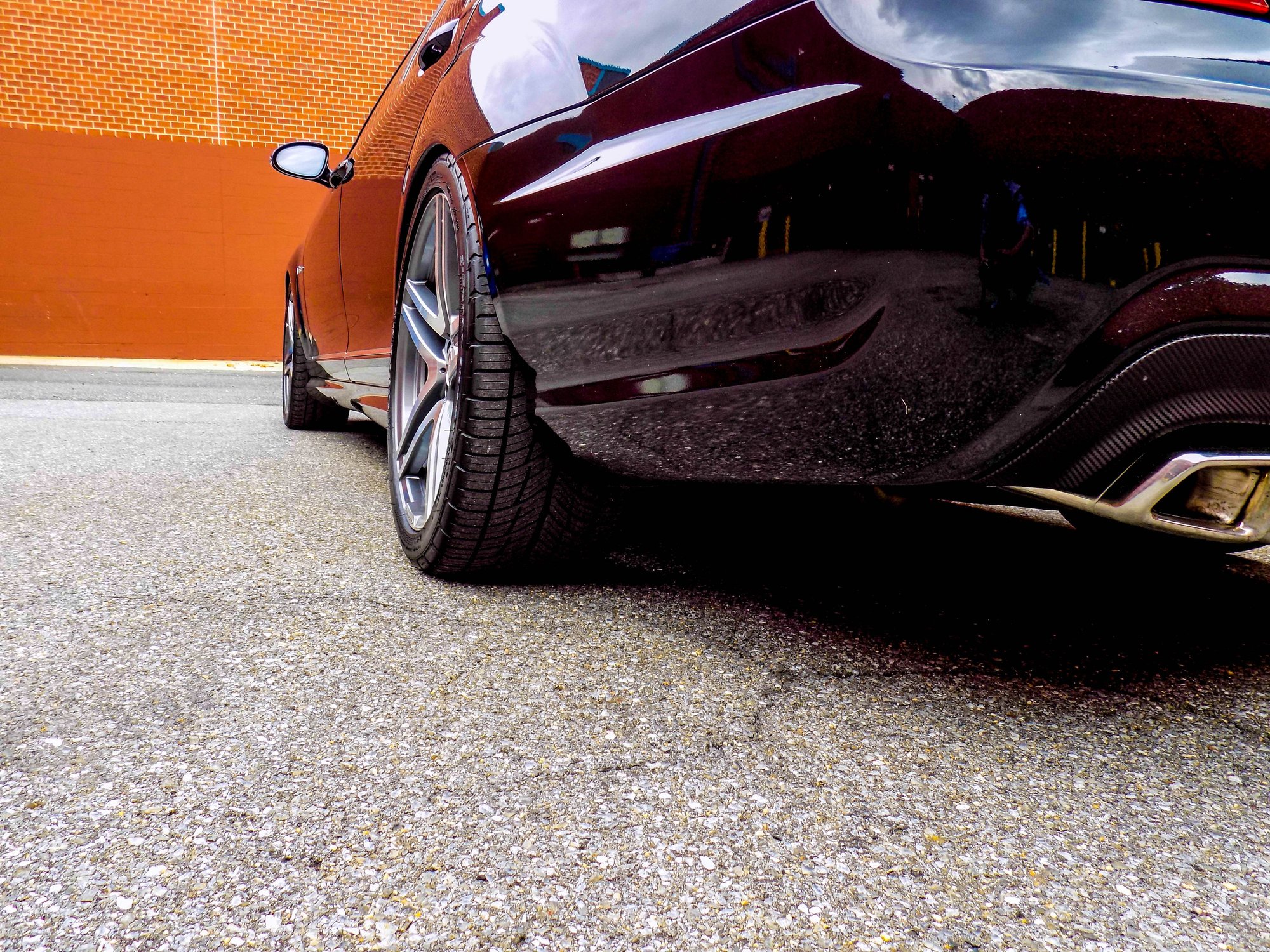

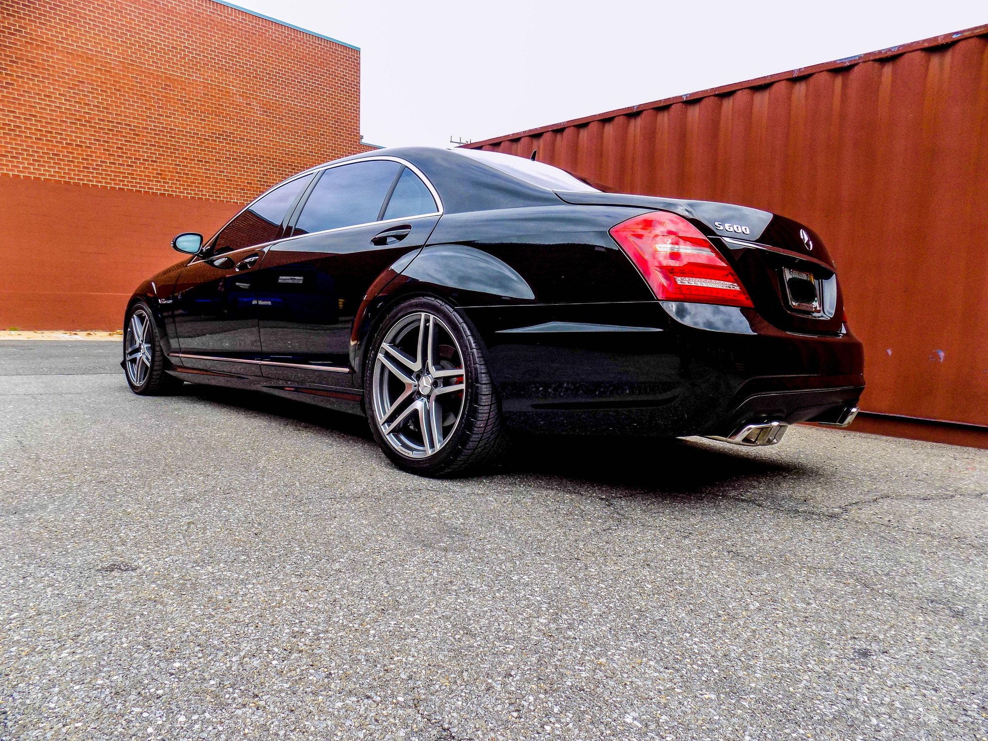

IMO, coming from two prior 220's myself and being wheel-obsessed, the "right" look for the car is staggered 20" with the OEM tire sizes, (255/35 front and 275/35 rear) and low offset wheels or OEM offset wheels with spacers. That fills the fender wheels without compromising ride quality. I think drops are dicey business, and when the car is low enough to make a difference it's too low to preserve the ride.
I'm on OEM S63 20" staggered with 20mm rear spacers and 15mm front, for effective offsets of 24mm rear and 29mm front. That's as close to flush as you can get without rubbing issues, or having to roll the fenders. You could also do aftermarket replica wheels at the standard 35mm offset. Not as aggressive but no need for spacers.

This is what replicas look like: 20x8 and 20x10 at 35mm front and rear. I am running thicker tires though - 255/40 fronts and 285/35 rears.

I'm only on spacers because I already had the OEM 44ETs. I'd avoid spacers if possible and just find aftermarket wheels with a lower offset. Less rotating mass and opportunity for vibration issues. You can go as low as 24ET rear and 29ET front. Those aren't going to be available as a replica wheel, you'd need to look for those in an aftermarket.
If you did go replica at 35mm all around, 10mm spacers on the rear would put you flush at 25mm, and 5mm front spacers would be flush at 30mm. (Don't sweat being a mm off, it's a sliver.) Get good spacers from HR Trak, not the cheap EBay stuff.
