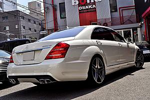

Hi guys
Ive started looking for a aftermarket rear bumper that can have dubble exhoust pipes on both sides.
I would love to find some that is good fit on.
Also woundering. I have parking sensors both front and back on my car. But on my bumper i have now i cant see any sensors?? Thats wierd isnt it?
Any tips on something that looks like on the pic here. Good price and good fit?

what ever bumper that doesnt have the parking sensor holes is a different bumper your car originally came with. you can get a s63 rear bumper with the pdc holes. as for the exhaust tips its easy take a look on ebay. i ordered all my stuff thru ebay. just look on there and you will find everything your looking for.

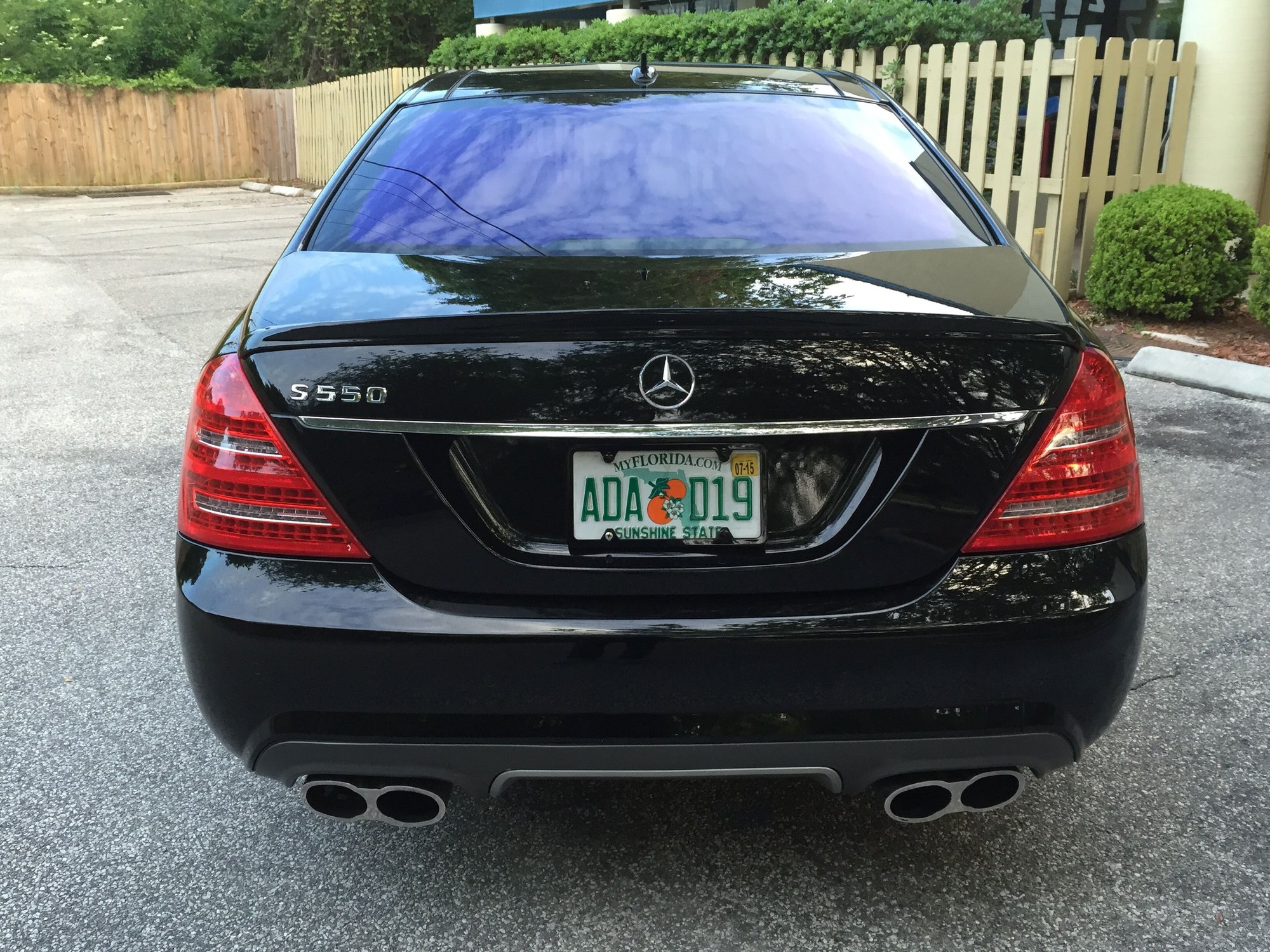

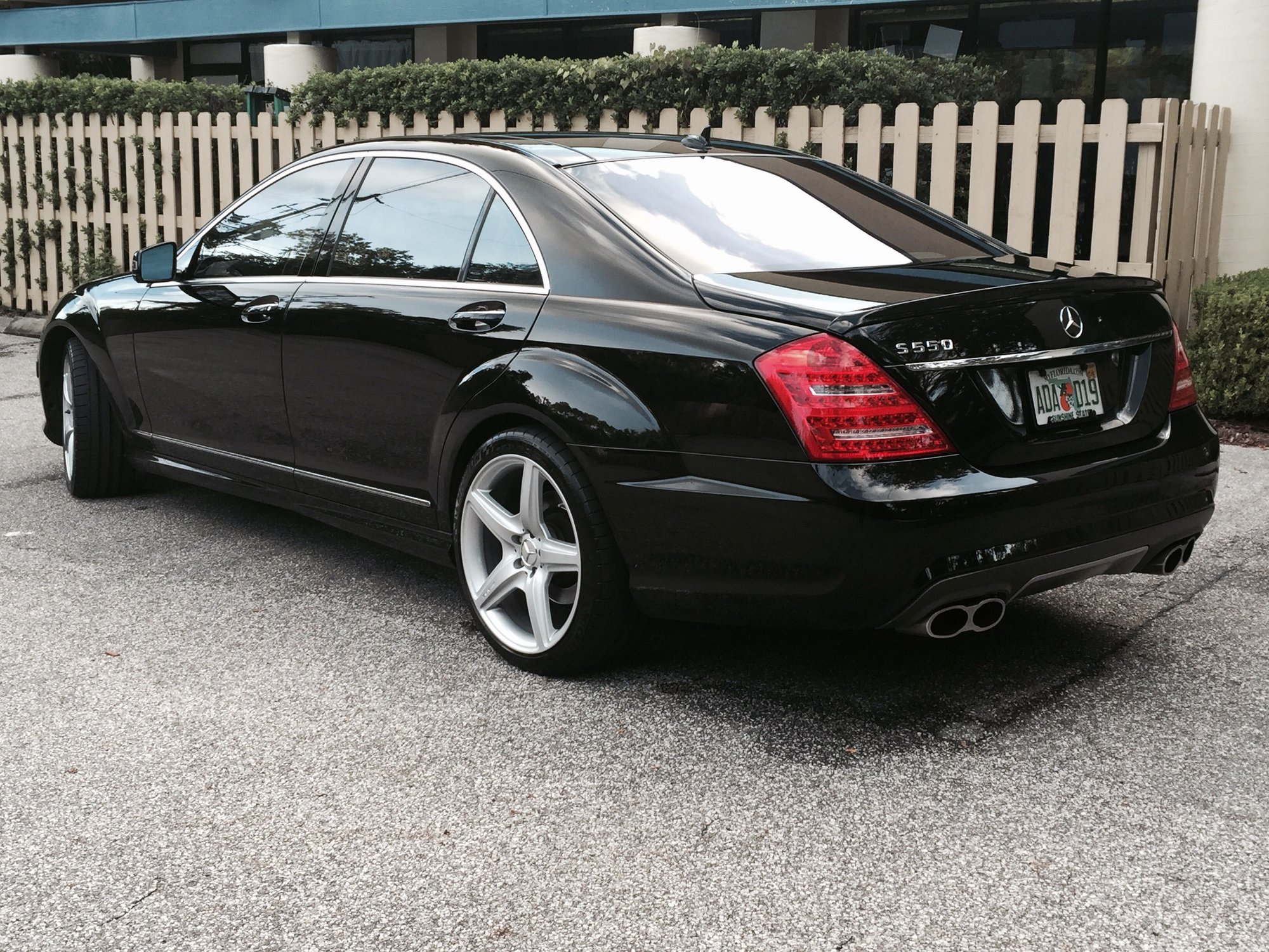

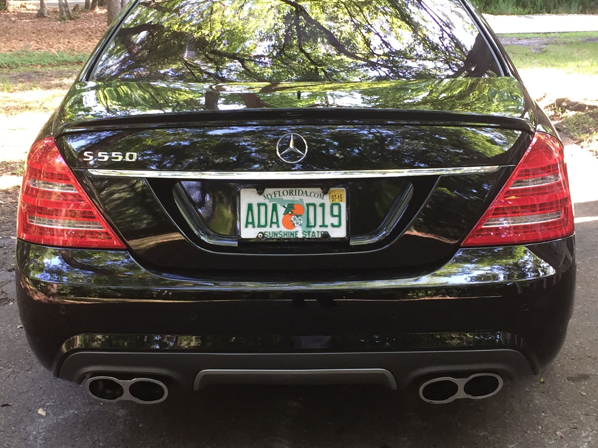

You can just swap out the lower bumper valence (called the "diffuser" on the forum.) It will not be a direct swap. The upper edge and sides will snap in perfectly, but two tabs on the bottom won't. I secured mine with two small black bungee cords.
The S63 diffuser comes in two pieces. The main section and then a small filler panel on the bottom. That panel comes unfinished and should be the body color but I shot mine in silver (Krylon Universal spray paint).
Both parts OEM from Rock Auto Parts for around $400.
One last thing, the bumper has an inner skeleton, part of which needs to be cut away to make room for the larger tips.
Here's the result:

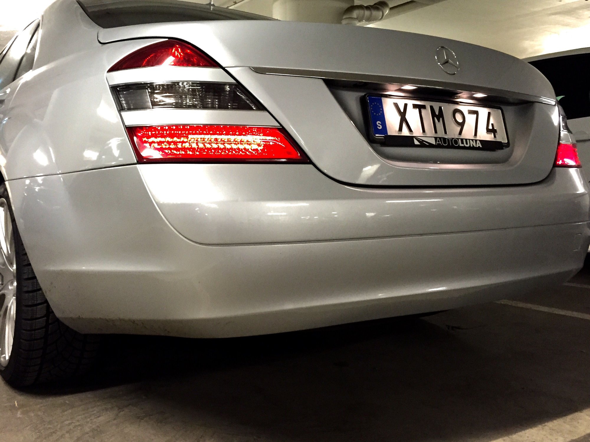

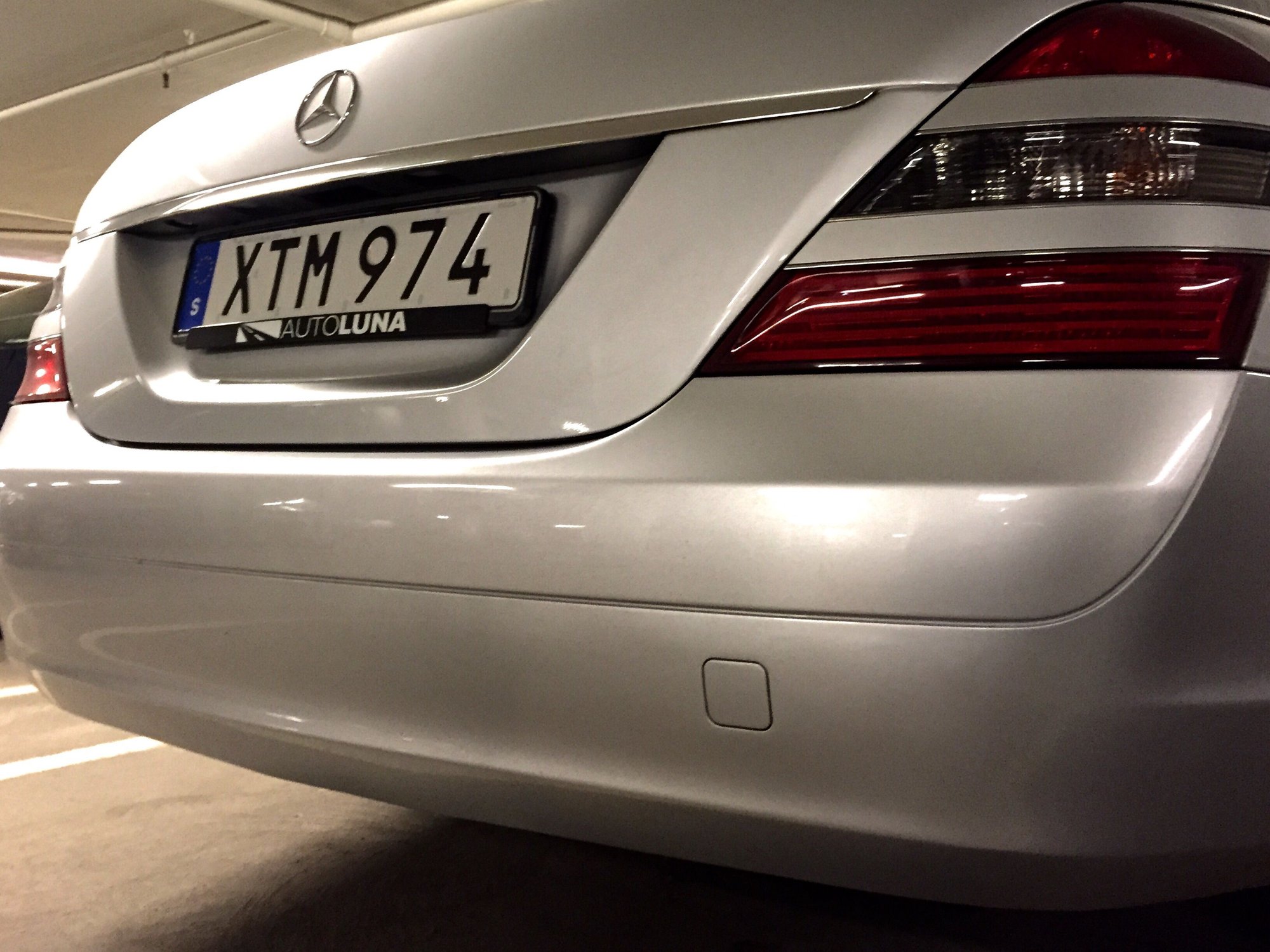

Hi!
Dont think that will work for me. Heres a picture of my bumper.. Dont have separate diffusor. Whole thing is one peice.

Yeah, you'd need an AMG sport package to start.

I have to assume that your car has Distronic Plus since it doesn't have the sensors in the outer bumper cover. Mine doesn't have the external sensors either as they are located behind the bumper cover. IMO, this makes for a cleaner look. You can find aftermarket S63/65 kits that come either with or without the holes to go with the way your car came. If you go with this kit, IMO the square tips look better with it.

honestly you should just look into getting the whole amg 63 kit. ive seen other benzs where they just add tips and it doesnt look right. like something is off. if you wait a week or so ill let you know how my kit fit i got off ebay. but most of the kits now you find are made of the same product as oem bumpers. so there shouldnt be fitment issues.

Hi and thanx
Yeah I hace Distronic Plus. So i can still go with a bumper without holes for the sensors and it will still work?
Square tips looks hot!
And you guys are right, looks best with full AMG kit. But i need to start with the back and add the sides and front/grill later on

Correct.

Damn that's sexy! I need those wheels.

Originally Posted by wilassasin
Mike I love the rear of your car too, you made a great choice
Thanks! I'm really happy with how it came together.

You can get those in a replica on EBay for around $800/set. Look for S65 AMG style wheel.
