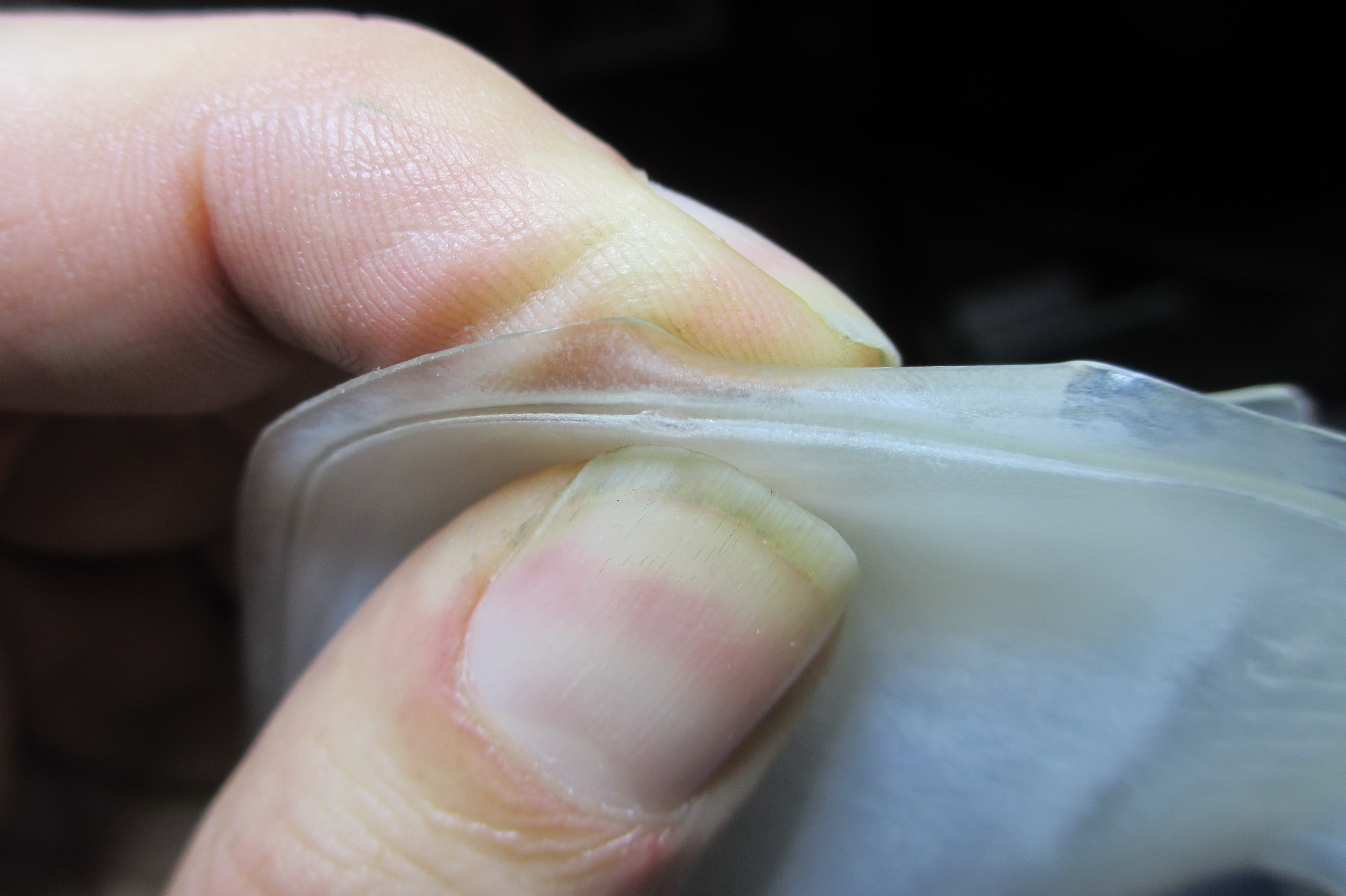

I have just fixed a leaking bladder in my car on the drivers seat cushion bolster. I've done a quick and dirty repair until I work out a more permanent solution. My solution is different from what most people attempt. Seems to be working so far. I will post a complete writeup in another thread.
Cheers.
Nice! Mine has been ruptured for awhile. I just can't justify paying 700 dollars for an airbag that don't necessarily need lol
