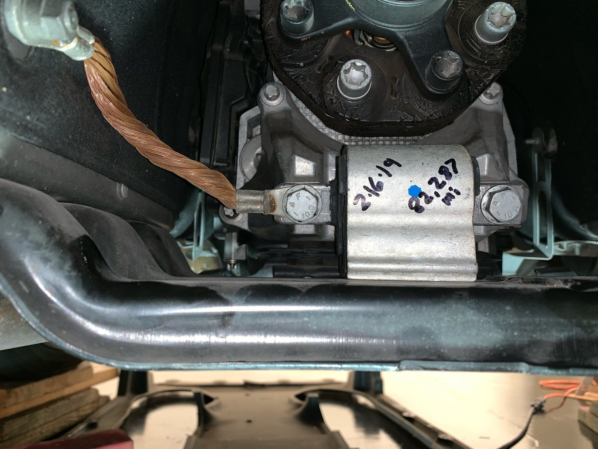

Does anyone know where the transmission ground is located on a 2011 S550 4matic? If you have a picture please post it would be very helpful.

Hi Cuzzo,
The transmission ground wire location is near the transmission mount. If you can, drive the car up onto ramps, remove the underside protection shield below the transmission, and peer above the transmission cross-brace—where the transmission mount sits. The transmission ground wire fastens between a bolt and the mount on the driver-side. The opposite end of the wire is affixed to the frame nearby, as the wire itself is less than a foot long.
I've included an image to help you understand, but please know that the image provided depicts a base W221. However, since you have a 4MATIC variant, the mount will look different.
