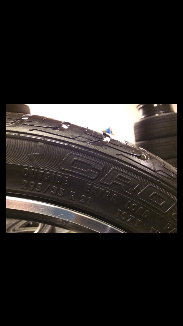

Hey i found a steal deal On g63 AMG wheels 21 Inch! and The tyres Are all 295/35/21 , wheels were taken OFF a ml63
Will theese wheels fit my car? I myself Think Maybe The rear Will fit fine but The fronts might need other tyres - if so, what Are my options?
Seller lives kinda far so i dont Want to go there and Get dissapointed Therefor i hope you guys could help me out :-)!
Car is w221 s320 cdi 08 lwb
Thanks ☺️☺️☺️

Pics of the wheel?

Originally Posted by Jason B
Pics of the wheel?
Photo attached , i cant post more than 1 Photo via iPhone apparently :-(
Attached Thumbnails Good deal On 21" G63 AMG wheels - 21x10.5 all Four - 295/35/21 - Can i fit theese?-image.jpg

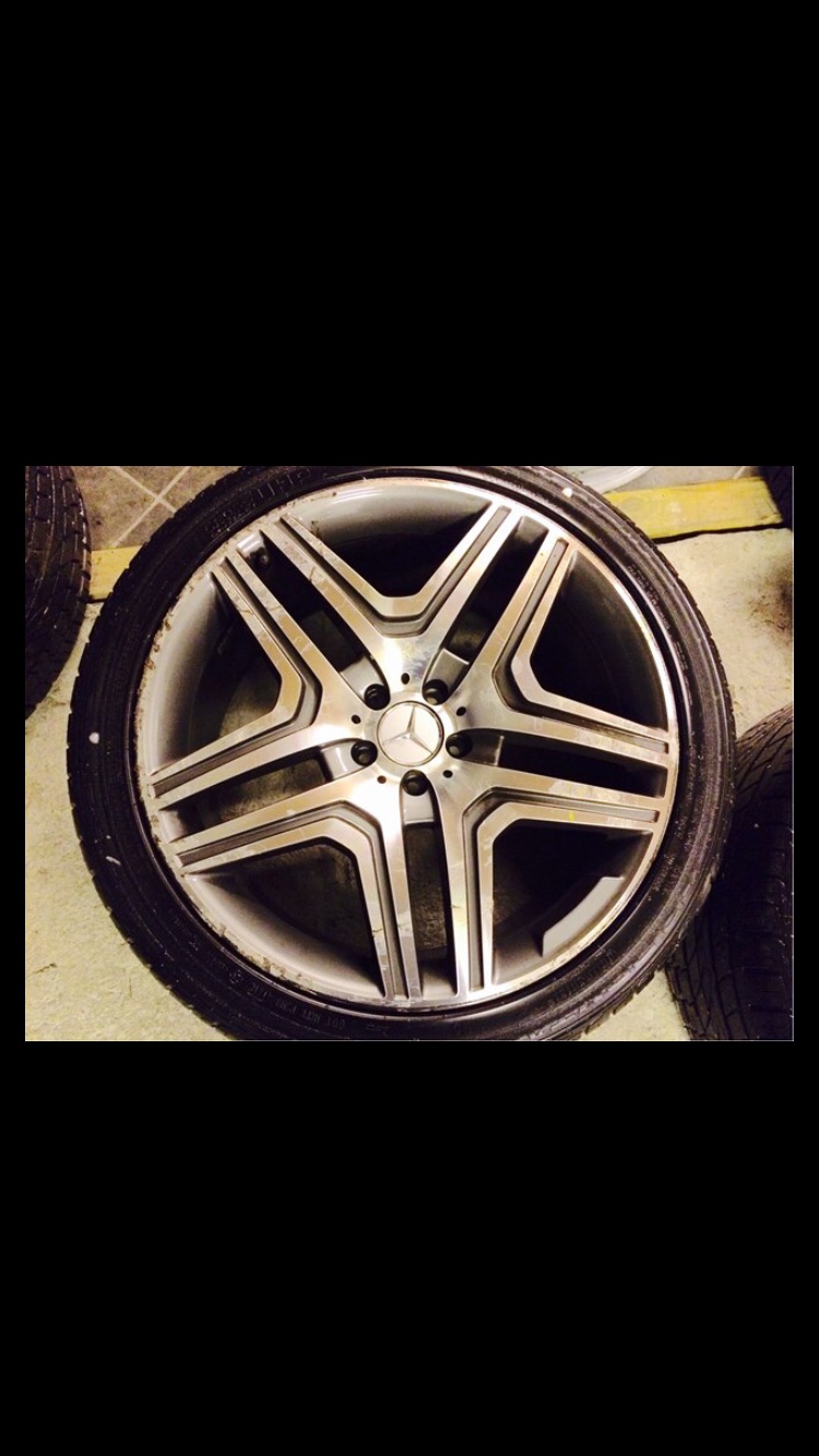

Old Feb 12, 2016 | 12:35 PM
Benzanw's Avatar
Joined: Jul 2015
Posts: 23
W221 s320 2008
Pics of the wheel?
More

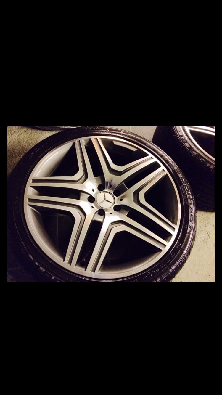

I mean a photo of the wheels....
Old Feb 12, 2016 | 12:47 PM
Benzanw's Avatar
Joined: Jul 2015
Posts: 23
W221 s320 2008
I belive i made 2 posts of pics?
But Here is another mate

Offset is 56mm, which is 12mm too high. Might be able to make it work with 10mm spacers all around. In think I've seen a pic of those wheels on a 221.

ML63AMG reps 21x10.5 all the way around

pretty sure u need a spacer in front and a 255 front tire.
