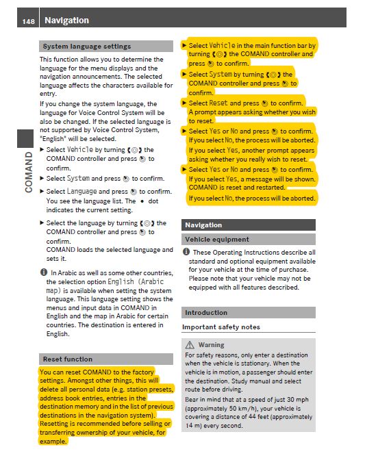

Try reset.

Try reset.
I did the reset, but same problem. Would you think that my on the phone address book is taking up all the memory space? I assumed that Comand gets the address book via bluetooth as opposed to downloading them.

40GB hard drive. See attachment. "Worst case" scenario hard drive may need replacement and if so, MB only offers complete control unit replacement.
DIY hard drive repair if so inclined: http://www.benzworld.org/forums/w221...ow-repair.html
