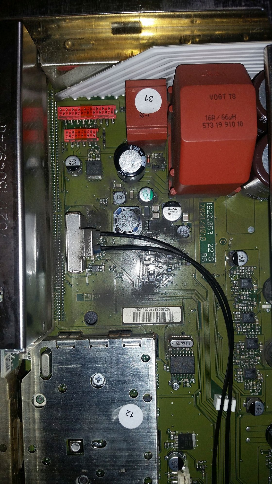

check to see if there is water in the amp, its possible

no water but i did look at the main amp board .. the black stuff on the board is right below the fan and unsure if its the problem . it doesnt look great but i do not see anything burnt.

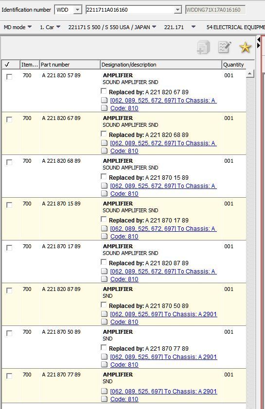

If you decide to replace amp and want to purchase replacement you will need part number to shop. You can shop part number listed on your amp but there are compatible part numbers that may be available to widen your search for best pricing only way I can provide these additional numbers is with your VIN - your call.
oh sweet ! WDDNG71X17A016160
File Type: pdf

so any of those part numbers are ok to replace it with? also what do you think about sending it in to be repaired? i found several sites that do that cheaper then the 700.00 for a used amp. and do i need to have the new one coded. the service adviser said 300.00 if it needs to be coded.
