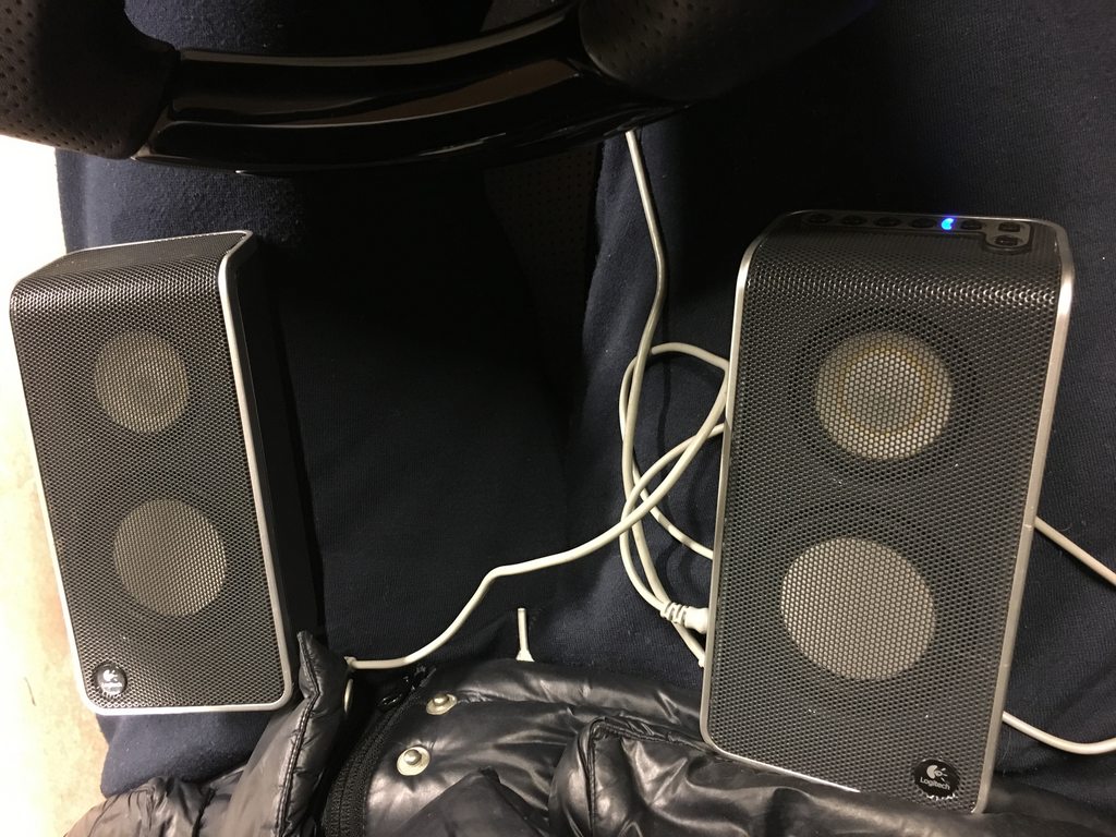

I bought the Pioneer TS44 speakers, but it turned out they were not in a sealed box, the rear is open so I don't think they will give good sound. Also they were a bit bigger than I hoped. So I'm just returning those and will try other options.
Today I thought I had a brilliant idea, I have some Logitech USB speakers which has no external power supply (power from USB only), so I hooked them up to one of the USB ports hoping it would work, cause they have really good sound considering their size. When I connect them I immediately get the blue power light. But no sound. I can even press the volume adjusters on the speakers and it shows up that it is changing volume on the screen. But no sound. Could not find anywhere to tweak it in the software either, but then again I am not familiar with Android. Any ideas if this should be fixable in the software somewhere? It would by far be the easiest and best solution for me, considering I can't get sound through the cars system itself..

If that solution would work for you, why not a nice JBL unit like a Charge 4? It will run/charge off of USB power and you could fairly easily strap it down like a fire extinguisher. Since we're getting creative about this. I have several of these in my house and garage, they're pretty awesome and durable. You should be able to connect it via Bluetooth to the Android unit.

I think the only way you're going to get sound from the tablet into the system is if you have a bluetooth connection between the tablet and a bluetooth dongle like Tune2Air connected to an iPad kit. Otherwise you would need a hard wired connection to AUX on your command and the headphone jack on the tablet.

The headunit doesn't output sound via bluetooth. It takes bluetooth as an input and outputs sound via physical wires. The iPod kit hooks up into the AUX wires at the back of the Comand...which the Japanese Comand doesn't have apparently. I would investigate if it's possible to add AUX to the jap version.

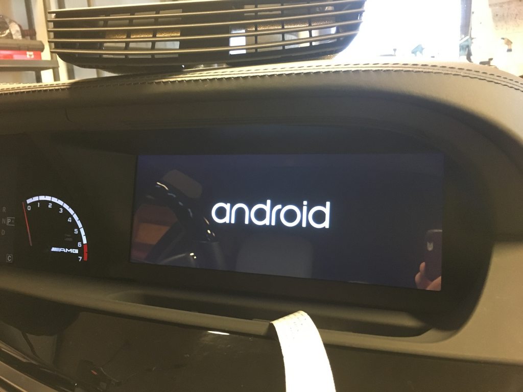

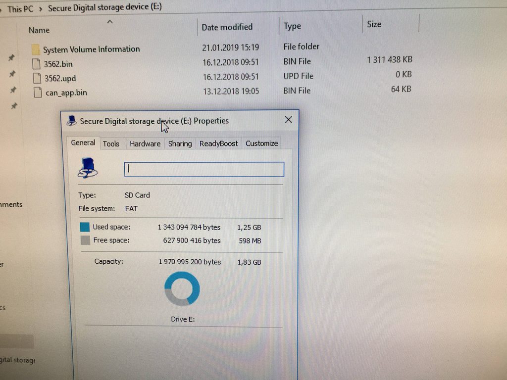

I tried to update the unit with the files megacrazy used, copied the update files to the SD card and put it in and turned on ignition. It starts to update but it just reboots on "update system" and then starts over in a loop. When I stop the loop, it loads normally except the "Mercedes-Benz" logo is gone at startup and now only "android".
Any ideas what's wrong?

Maybe because you already have the same version of the software? I updated mine because I had an older version than you.

Ah, ok...I see. Should have just left it alone then..
So - I got the MB star back as "BOOT LOGO" in the general settings, but when trying to update start screen to get the "android" startup screen away(which appears after the MB star has been there for some seconds), going to "software version" then settings and code 12345678 and pressing the upper button in chinese, it just stays with the spinning "wait" icon forever. I waited at least 10 minutes before just powering off, and restarting. Then nothing was changed. Do I need to get the file and put it on a USB? I tried to google to find something, but couldn't find anything. Anyone have a link or something to the "Mercedes-Benz" and "AMG" startup screens, if that's what's needed?
Yeah there's a difference between the boot logo (mercedes sign) and boot animation (AMG or Mercedes boot animation). Android stores the animation in /system/media. You need a copy of the animation you want copied over there. Email the people where you bought it see if they can give you the animations. If not somebody might be able to get a copy from their version of the firmware...might be problematic because it might need root access though. I'll take a look and see if I can access that location later.
